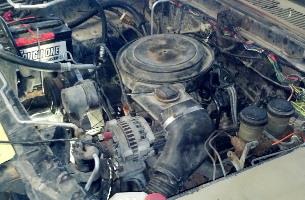

I'm doing a 4.3 swap out of A 90 s10 right now and its not that hard if your putting it in a 2wd but if your planning to put it in a 4wd plan for a lot of time, money, and fab work. The best place to get a bolt in set up is http://www.Powerbyace.com I used there motor mount brackets and they work great. And tbi is easier but gets tricky trying to find a place to mount the computer if you have A/C. I'm even using the serpentine belt system minis The P/S.
File comment: Its a tight fit but I looks like it belongs
