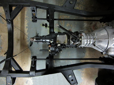

PostPosted: Sun Apr 17, 2011 11:35 am
Somebody on this site had the measurements and i cant find the ones i wrote down.But when you install the trans you can see where to start your cuts .
The 5 speed stick is in the stock position close enough that it belongs there.
What i did was cut the stock X-member out and cut it and mounted it the the transfer case to keep the E brake linkage in stock position .
I used the Trooper X-member cut 3 in out each side and dropped it i think 2in then made angle iron mounts using 4 of the 6 bolts on each side putting the strength back into the chassis.
i will try to repair the pics so you can see it better.

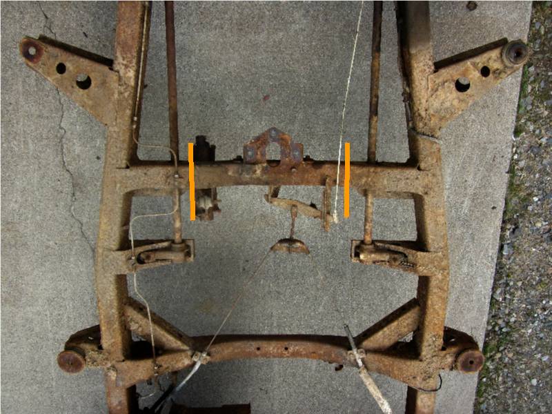

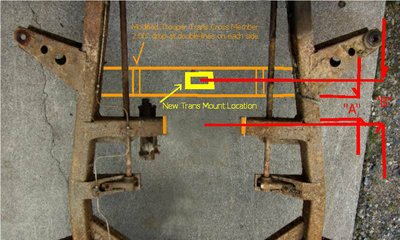

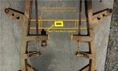

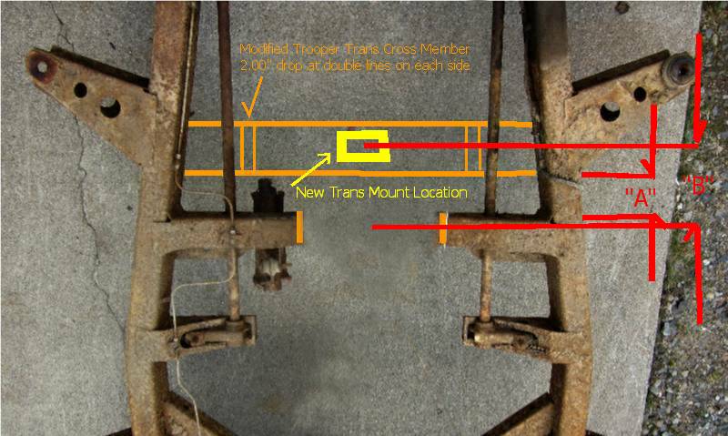

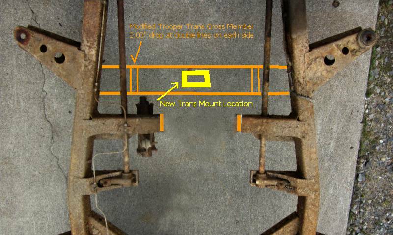

Here is the frame with the cab removed, I photo shopped the current cross member to show the proposed cut area. I plan to reuse the center portion for the E-brake mount as you did.
I marked the areas that I'm thinking need to be changed based on your photos and instruction. Does this look right? If so could you tell be the dimensions on your truck for "A" and "B" on my photos?
Thanks!

PostPosted: Wed Jun 01, 2011 8:38 pm
:esurprised Now thats cheating :ebiggrin as i did mine from under the truck but you got the plan just right but after cuting the cross member out install the trans/engine assy and bolt it in to make sure you can get the crossmember in just right. Also on the rear driveline be sure your truck is at ride hight when you start to measure and fit it.

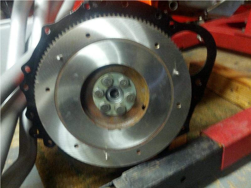

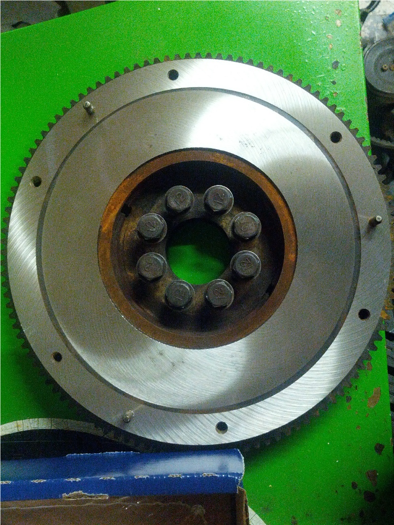

CRAP! .........Now I have a big decision to make. I had my engine rebuilt by a local rebuilder last year, they do a lot of volume with small engines. They offer a 5 year warranty and back thier work with a reputation of quality. It's been in mothballs awaiting installation since then and now that I'm putting things together I'm noting some issues. #1. it has a 200 head on it as opposed to the 180 head it was wearing when I dropped it off, not a huge deal but a potential drop in compression if that's all they swapped. Next, and this is the bigger deal, the crank is a 6 bolt 2WD unit while my original was an 8 bolt 4WD unit. Now my original flywheel won't bolt on and the clutch is slightly smaller as well. I had a 6 bolt flywheel laying around so I had it machined and bolted it on, I also bought (another) new clutch for the 2WD application so here I sit with 2 brand new clutches and flywheels (parts store I bought the other clutch from is now out of business so no exchanges possible).
The dliema: Do I force the engine shop to give me a correct 180 engine with the correct 180 head and 8 bolt 4 WD crank, or do I just add the 2WD flywheel clutch setup and call it a day? Will the 2WD clutch be enough clutch for the 4WD setup?
Help!

PostPosted: Sun Jun 10, 2012 5:21 pm
Posts: 906
Location: N W Arkansas
Look on the block just above the driver side motor mount, G200 will be cast into the engine if it is a 1.9 lower end. If the machine shop gave you a complete rebuilt 1.9 in lieu of a 1.8 then you are good to go. If you have a 1.9 head on a 1.8 block I would talk with them about correcting it.
As far as I know all G180-G200 had a 6-bolt crank/flywheel, 4Z engines have a 8-bolt. The 4wd 1.8 and the 1.9 use the same flywheel and the 8-1/2" clutch rather than the 2wd 8", but that should be the only difference. Are you absolutely sure about the old engine having an 8-bolt crank? You sure it's not from a 2.3? I have a 6-bolt 1.8 flywheel on my 1.9 right now.
Once you get the engine size straightened out this is what I would do: buy a new 1.9 flywheel from say rockauto.com (they are less than a new clutch & not much more than having an old one resurfaced), then use the 8-1/2" clutch you have, sell the new 2wd clutch and resurfaced flywheel.

Ok, it's definately a G180 block with a G200 head. The crank is a 6 bolt. So, will the 1.9 rock auto flywheel fit the 6 bolt crank and accept the 8.5 clutch and pressure plate?

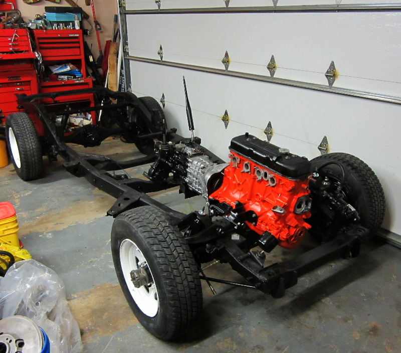

Well I went back to the engine builder and had them swap the head for a 180 head (all fresh with new valves, etc.) and pushed the issue about the flywheel not working. They came up with a 6 bolt flywheel that accepts an 8.50" clutch (I don't know where they got it) and it all bolted up nice. Here's todays latest progress, the engine mounts are bolted up and I'm sorting out the final position of the trans before I make the mods to clear the transfer case and add the new trans mount cross member. I'm considering clearancing the current cross member without removing the center entirely (it's a tight fit, most will need to be cut away so it might not be possible without adding back some further reinforcements) and adding an extension bracket forward for the new mount location rather than an entirely new cross member in the forward location. I'll post results as soon as I have them.
