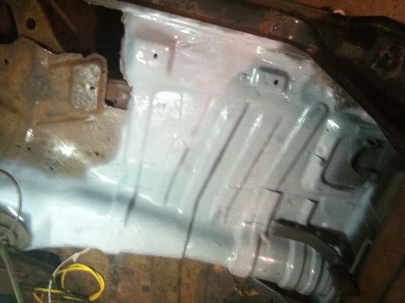

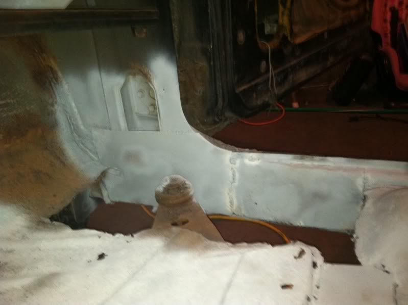

Only pictures I have of the truck on my phone will get more
Here's some of the work I have done
Cut out old rusty floors, inner rockers and cab mounts then fabbing new and welding in
