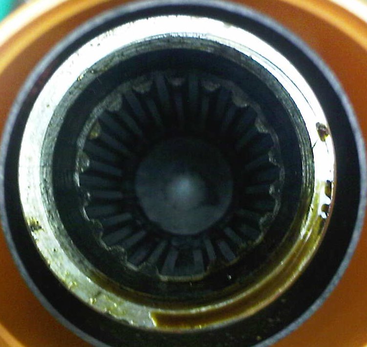

Here's a shot of the old-style yoke, looking down into it. I'll let you count splines. It's from
viewtopic.php?f=8&t=22109&p=161754#p161754

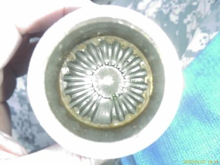

Now, here's a shot from the same angle, of a yoke from later-model Isuzu 5-speed--specifically, from an '86 2.3L 5-speed 2wd. Again, you can count the splines.
