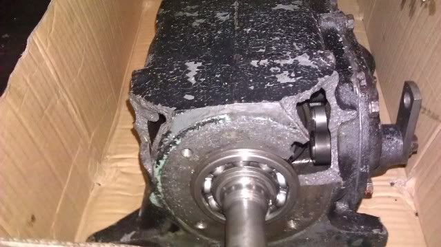

Did some measurements on my saginaw and based on the dimensions of the TKO, the TKO is only about 2 or 3 inches longer. Since the TKO has multiple shifter locations the shifter should line up just right too. I might have to carve a little bit out of the trans tunnel but nothing major i dont think. Im also going to have to modify my trans mount but that shouldnt be a problem. Maybe a new driveshaft too. It will probably take me little while to save up the money for the new tranny but i'll try and post the install on here if anyone is interested. It'll be a lot nicer to cruise down the freeway at a 2000 RPM's vs 3200. Heres what happens when you put a weak 4 speed in between a 388 sbc and a 9 inch though. Oops. 8O.
