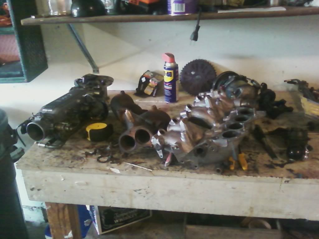

Nissan KA24E
tha manifolds etc from that motor 1/2 way through gasket scraping
this is not the motor i will be dropping in first. i have 2 of them this one needs the head gasket.
so i plan to drop in the other one which is in good shape/running, and still fully assembled, use it for a couple months while i build this one up, pull it out and swap this one in. will probably use this one to design the mounts and such since it is a long block and doesnt have the manifolds attatched so i can manuver it around easier.
