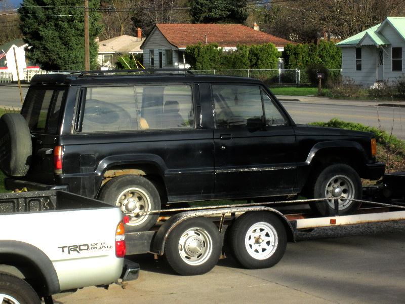

Home with my $200.00 prize...... Rod exited the oil pan so the block and crank are likely junk, all else is there and complete to rape and pilage

Those tires and wheels will fit and are lighter then the steel wheels.
Save the intake/carb,filter assy. and the dist. as that is what you need to do the 2.6 install or sell to some one who is doing a 2.6 install.

On the wheels and tires, yes that was the plan, they are 15.00" rims and in really nice shape (my stockers are 14.00"), the center caps cover the wheel hub, do I just leave them off the fronts?
*I'm trying to figure out an easy way to gut the running gear and still have a way to transport the rest to the wrecking yard. Looks like a job for captain sawsall right now! Kind of a shame, the Trooper is nice looking than my Luv! :lol:
