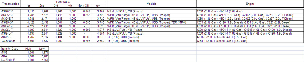

pups 81/85 and trops 84/85
have the same 4sp 4WD MSG as the 79/80 4X4 luvs
86/87 its a 5sp 14.5% O\D 5" longer and 1st, 2nd, 3rd is a geared a touch different other than that, its the same trans.
its found in 4WD pups and trops 86/87
click on photo to make bigger.
