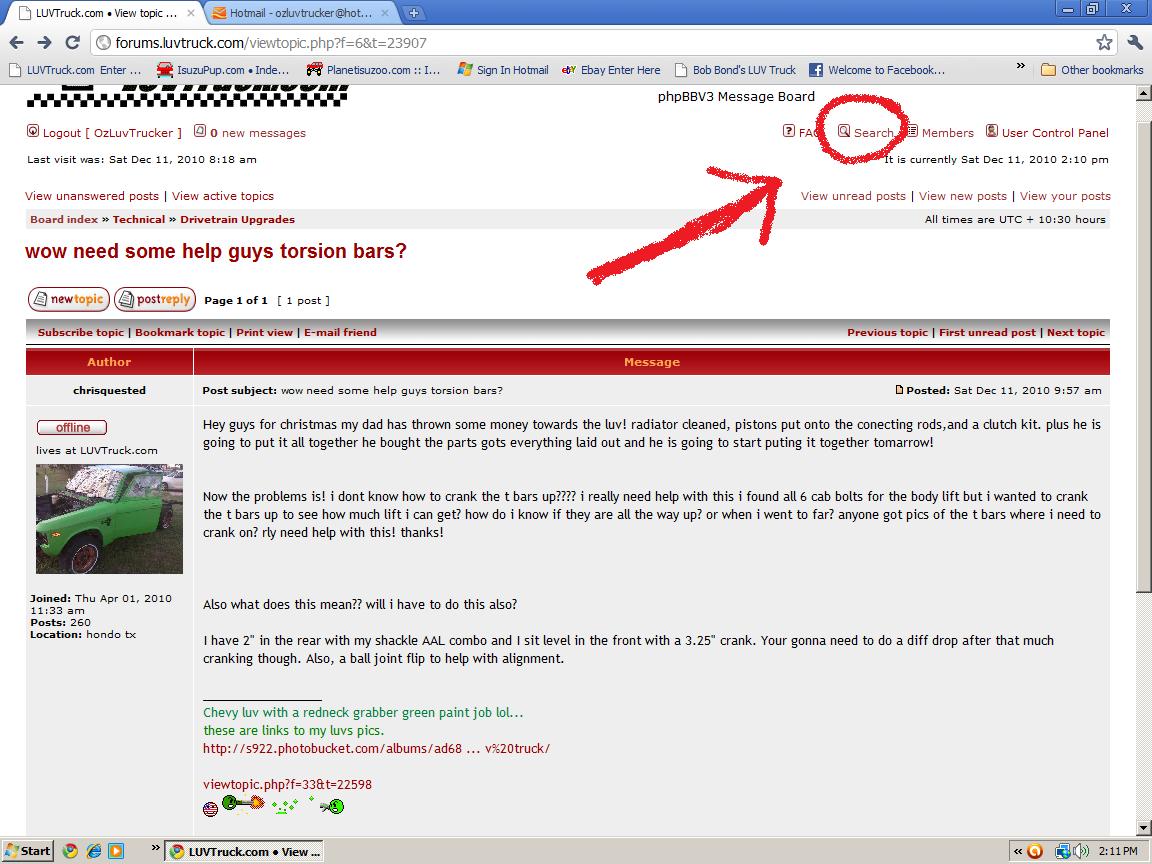

Become Friends With The Search Button

well i did search but it just comes up so much stuff on buying/selling stuff and everything so much stuff.
