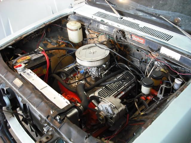

I second the V8 nomination. I think the V8 swap is easier since it has been done so much. A V8 swap doesn't have to be a drag truck. You can go for mild build and have a very reliable and still mostly stock truck that is fun as hell to drive. I am a little biased having a 307 in my luv, plus I have driven small block chevys for 35 years.

Two questions come to mind, if you like it the way it is, why the change? If you have made up your mind to make a change, which combo do you lean toward? I can tell you from experience that driving a V8 Luv is about the most fun you can have with your clothes on. The expressions on the faces of the people I have surprised still make me smile. Besides you can buy 350/350 parts about as cheap as Luv parts or cheaper. As far as the disrtibutor is concerned, just get yourself an 8 lb. firewall indentation maker, they do the job really well.

I use a crab cap (big Ford) cap on my crank trigger set up, before that, I had a small cap MSD, no firewall bashing, and I have a short style water pump set up on mine, with a low mount alternator, the crank trigger eye, a vacuum pump, and an electric water pump drive on mine. Tight but fits. Somewhere on the board is a thread about a radiator size and mod to the firewall so it will fit...
