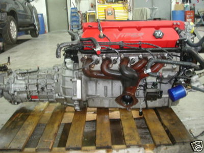

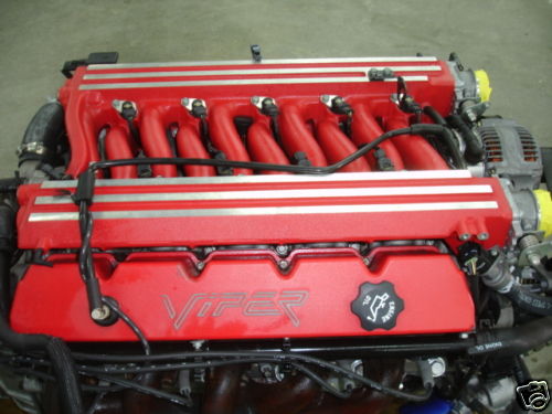

i think haveing a first gen viper engine would be awsome what do you guys think

its almost a waste of time to swap.
I have the truck version of this same motor (cast iron not alum) and its SUPER long.
fairly narrow, but way too long. would have to push the firewall back a solid foot. and the front to rear weight distribution would make it terrible at the track.
just think dodge 318 with 2 cylinders added.

ENGINE: Engine Bay:
Length is 36” 32'' fire wall to hood cross member
Width (outside of manifold to manifold) is 31” 32'' inside fender well at bottom
Height (bottom of pan to top of intake) is 21” 40'' something
TRANSMISSION:
Height is 17 ¼ n/a
Width is 21 n/a
Length is 32 ¼ n/a (worried about the shifter)
i was thinking of puting the radiator in the bed and have a duct supply air. Also have electric fans. Fuel cell as far back as i can set it.
gosh guys it comes with the computer and the wiring harness 30,000 miles....if i only had the money buy it now 6,000
