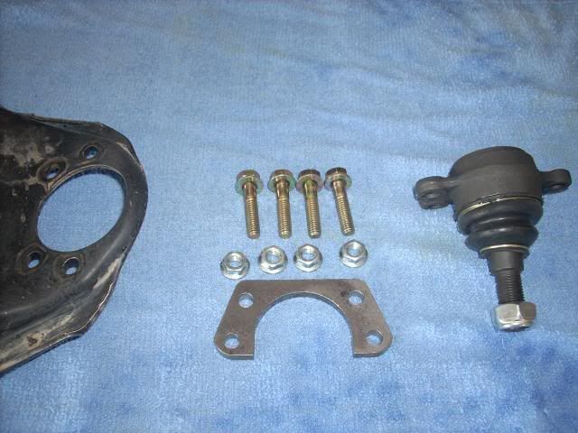

These are pics of my truck with a T Bar lift and rebuilt rear springs using Trooper leafs,Power steering ,and Trooper upper control arms and spacer kit.

PostPosted: Sat Sep 11, 2010 7:09 pm
I the pic's of the rear springs the main leaf is the stock spring and the rest are Trooper leafs,the long one being the Trooper main leaf with the eye's cut off.
The Trooper springs have a lot more arch to them and the leafs are thicker.
I was going to use the Trooper springs as a set but the spring bolt is almost two in's forward and means moving the front mount forward about 2 in's and that means pulling the bed and fuel tank. NOT Or the axle would be rearward about two in's and if i remember right the spring pack was like 1 3/4 in's longer then the Luv spring.
