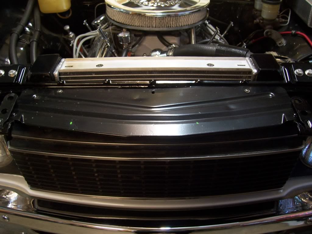

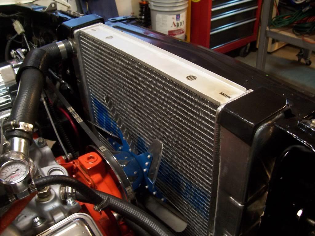

Got the radiator in at last. Still need to mount my trans cooler and run the lines and I'll be close to having the LUV back on the road soon.
 Post subject: Re: Radiator mount
PostPosted: Fri Jan 28, 2011 7:31 pm
Joined: Sat Nov 14, 2009 8:52 pm
Posts: 35
Here are some pics of the mounts.ImageImage
