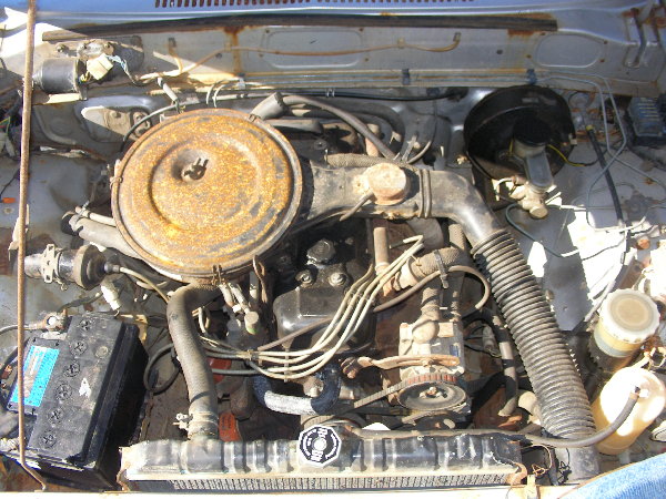

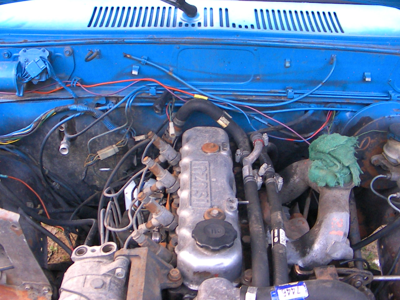

yes 85 back, there is no 2.3L gas engine.
1.9L gassers have the distributer on the front of the engine.
like this photo
THE 2.3L ENGINE DISTRIBUTER ARE AT THE REAR OF THE ENGINE.
2.2L Diesels looks like this
well ok the 2.2L is missing some stuff :lol:
