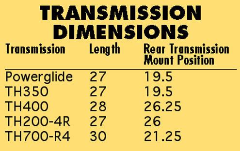

The disadvantage to the 200R4 is its mounting length. You will have to cut and weld on the torsion bar xmember to correctly mount it. The mount is towards the rear of the xmember. If you mount it on top you will have the trans too high and cannot get the proper driveline angle. The correct line is for the pinion centerline and the engine / trans center line to be parallel. U joints should always have the opposite angle on the ends. As a ujoint turns it will accellerate and decellerate the drive shaft. With opposing angles when the front accellerate the rear decellerate and vice versa. This is the onr reason that the factories used constant velocity U joints on thier cars.

They do not agree with each other. I know the powerglide and the th350 are the same.
