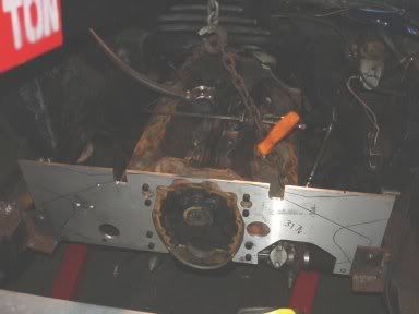

As far as I know it does and it fits toyota and datsun. I could be wrong. Another way to install it is with a motor plate, makes it easier to mount Alt and PWS-
http://www.cachassisworks.com/c-155-mot ... assis.aspx
oh ok. i will check on that. that picture of the front clip look like it might be out of my price range though.
The pic just showed how it was mounted, you can mount it on a stock frame.
These guys used one to mount a SBC in a fox body-
ImageImage[/quote]
oh ok. i will check on that. that picture of the front clip look like it might be out of my price range though.[/quote]
Image[/quote]
oh ok my bad sorry. i had one of them back when i did my 91 LX with the 434 SBC swap in it. im gonna check in on that plate though. the way it was in that demo i thought it was the whole clip and i was like that 2 or 3,000 bucks alone lol my bad tho man. ill deffently check in on that plate, thanks 8)
