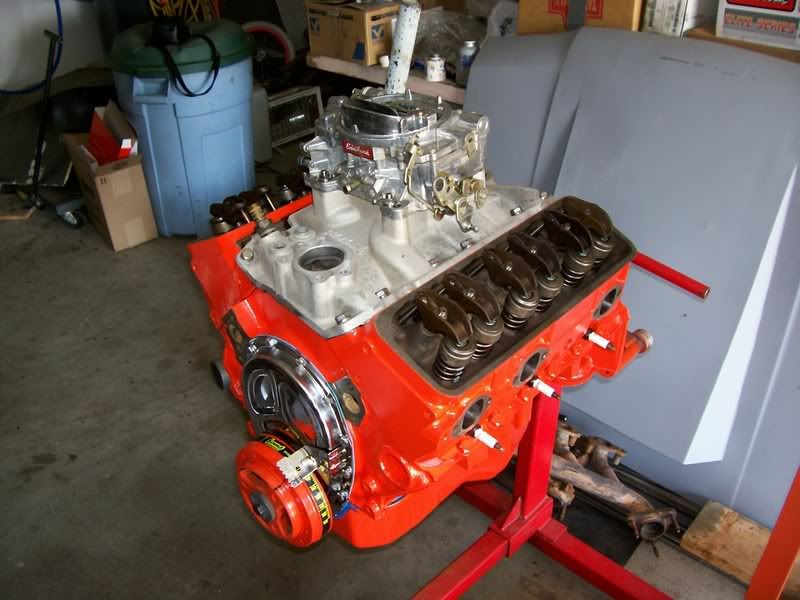

the 4.3l v6 is the same as the 3.8l v6. last i new.
this is a 4.3l V6 a 1988. the 2000 4.3l has a balance shaft in it .
so the timing cover is a little diffrent

I like that! I am gonna try to stay fuel injected, but I think the jump in power might be good for me, and I drive around 150 miles a day and want to use the truck to do it!
Well, that and mess with some little racers

Correct on the balance shaft, mine has it. You can tell by the plastic timing cover. Not sure about the 3.8 but the 4.3 took early Camaro motor mounts and I welded in the Hooker mounts farther back then they would have been for a V-8. I think the engine/trans combo you picked will work great for the amount of driving you do.

The Buick 3.8L engine is a completely different engine series than the Chevy 4.3L engine. Nothing interchanges. The engine mounting is also different as is the exhaust flange.
