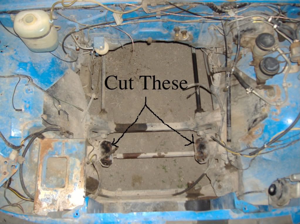

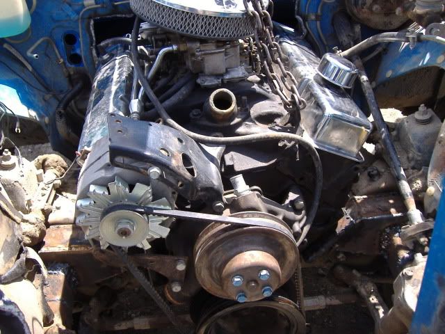

I am currently putting in a 350 in my 75 Luv and need some advice. I don't have a lot of money (literally, less than $100) at the moment but starting a job this month. I'm putting this Image
into this
That motor came out of a 1965 Chevy Biscayne

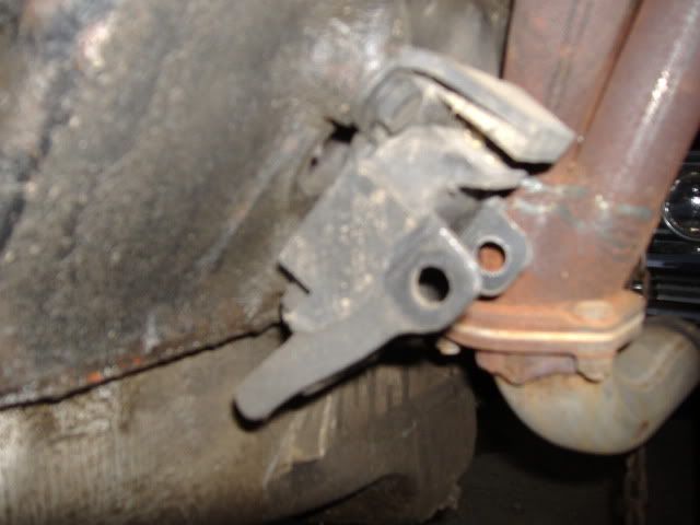

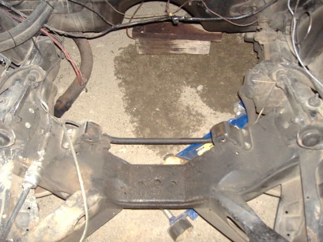

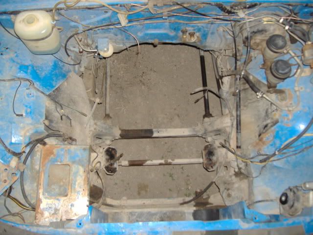

and I'm using the old motor mounts on that which look a little like this
The motor rested on two notches on the frame as shown
I was thinking about cutting off the slabs on my pickup frame to make it look similar to the Biscayne's.
The measurements of the motor mount for the motor was around 2 5/8 in. and the frame on my pickup was just 1/32 smaller than that. What do you guys think about it? Will it work?

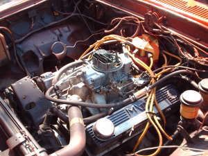

It may put the motor to far to the back. I have put a 327 in mine and I am using the Hooker motor swap kit for a LUV I got from SummitRacing.com. http://store.summitracing.com/partdetail.asp?autofilter=1&part=HOK-12606HKR&N=700+4294925054+4294908216+4294905279+4294925130+115&autoview=sku
The mounts sit about 3" ahead of the old motor mounts and I had to massage the trans tunnel with a BFH. Here is a picture of the motor installed
It doesn't show the stock motor mount location very well but it is located below the middle set of header tubes.
Here is a very good guide about the basic of the V8 LUV swap http://www.luvtruck.com/pdf/engswap.pdf
Also OldRob one of the members here does a nice set of bolt in motor mounts (the hooker ones are weld in)

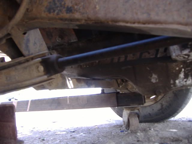

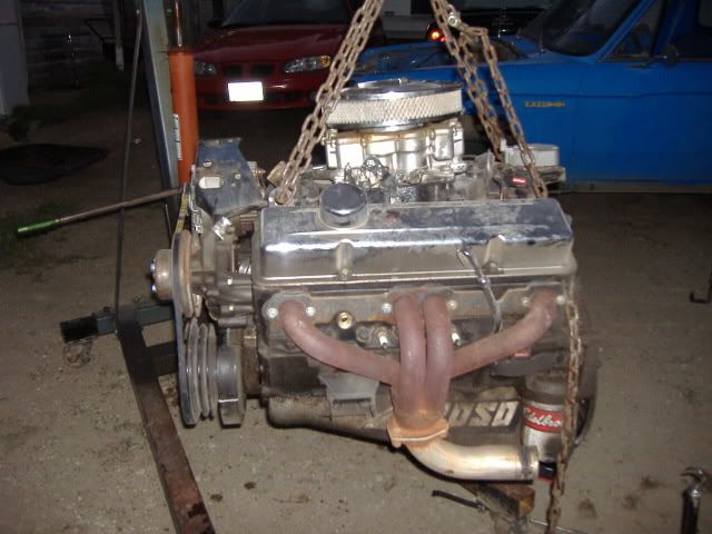

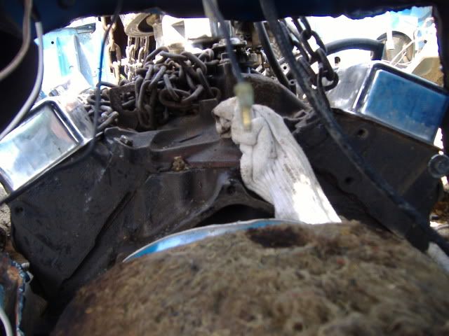

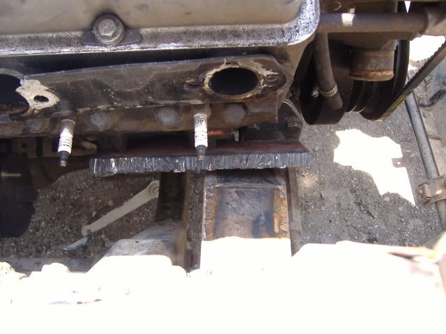

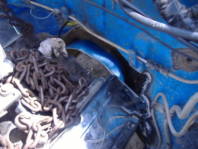

Alright, so far I have accomplished this.
As you can see, the mounts don't quite fit on all the way but I think that it's because my pan is hitting what I think is called the "A Frame" (It's the last picture.) Do you guys have any suggestions on what I should do about this? Also take note of the turning bar located almost right underneath of the pulleys. It's right in between the motor and the pulley so I don't want to move it forward or back anymore than what it has to.

It looks like you have the engine hard mounted to the frame. Is it possible to raise the engine 1/2" or so? This should allow adequate oil pan/crossmember clearance and might even allow better clearance for the tie rod.

You're hitting the oil pan because you have the engine too low. The ideal position of the engine crankshaft center line should be the same as the original engines centerline.

If you pull the engine back out, and weld the firewall back together you will be miles ahead. Take some time to listen to what Old Rob is saying and go to his site. He has done over a hundred of these, and already has the parts much cheaper that you can buy them anywhere else. All the work has already been done for you, and all you have to do is add sweat and follow the directions. Another note: some collectors will pay you enough for that 65 327 to get you a good late model 350/350, or 350/700r4 if that's the direction you want to go in. Otherwise it would be a great little motor for the truck. I would even leave the powerglide behind it.
