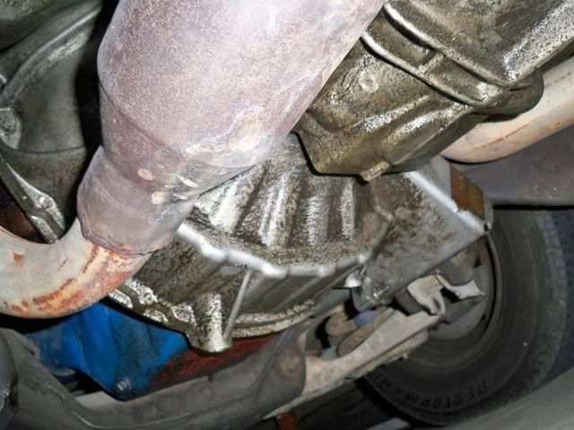

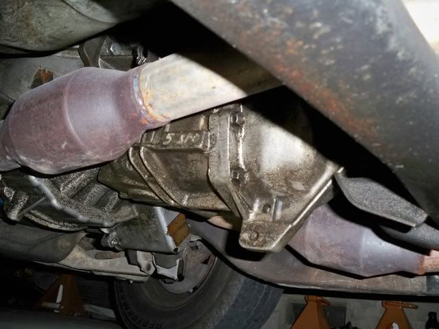

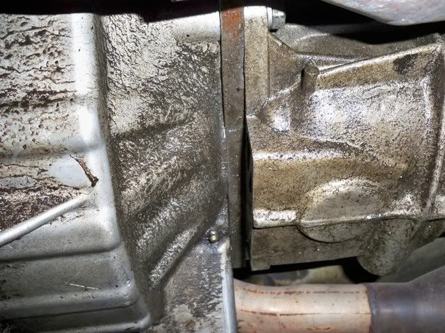

i know this is kinda an old thread, i stumbled upon it looking for 5spd info
just thought i would throw this in here, i had a v8 s10, had a 305/t5 in it, the tag on the t5 said it came outta a 93 2.5l 4cyl, and i drove this thing HARD!!...never had any shifting issues when i would turn it 8000 rpms, side stepped the clutch several times, went 14.38 @ 98.02 with a 2.3x 60'
it used a bellhousing/slave cylinder off a late 80s early 90s fullsize v8 truck, the tranny would bolt right up to the bellhousing with a 3/4-7/8" spacer between the two, worked perfect
