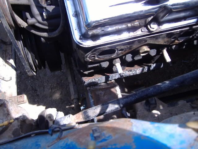

I have a 350 and I really rigged it in my Chevy Luv so here's the question....... I really don't know how I would get headers in there due to me hard mounting my motor in somewhat like this...
I have the motor welded with some cylinder spacers but this is the closest picture that I have to show how tight it will be until I get another actual picture tomorrow. So I was wondering if I should try exhaust manifolds for this. Does anyone have any suggestions on what type of manifold I should get? If you need more pictures, I'll get some tomorrow.

You should be able to use block hugger headers. I used patriot block huggers on mine, most other brands will fit too.

stock manifolds dont work i tryind it with my luv v8 that im building it dumps out right in the the frame i think ram air would work

depends on the exhaust manifold. I have seen them on Luv trucks. Depends on the engine mounts, engine location, torsion bars and all kinds of stuff. Get friendly with your local junk yard man. He might let you take some home and give them a try. They should be almost free.
