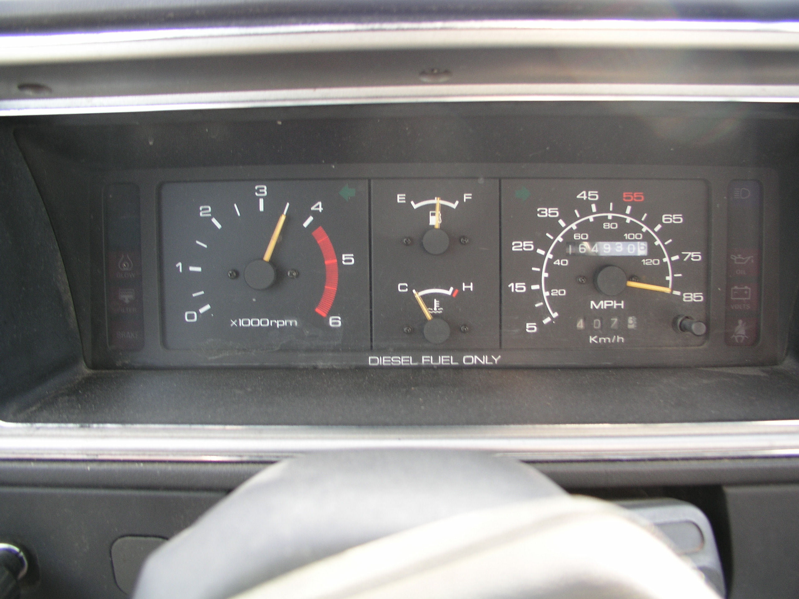

I don't know what gear ratios are in the R154, but if the first gear is much higher than the stock Isuzu 5-speed, you might not want a 3.42. I have the Isuzu 5-speed and the 3.73 diff that always came with that transmission. At 65 mph, I'm turning ~2,700 RPM, which is no sweat. I've buried the 85-mph speedometer (probably about 90) and still wasn't at the 4,250 RPM redline. I'm assuming the TDI is a higher-revving engine than my C223, so I'm thinking the 3.73 may be perfect for you. And it's MUCH easier to find than the 3.42, since it came on every 2wd 5-speed P'up.
Edit: I found a photo, courtesy of "graydonblair" at the IsuzuPup.com forum. This one is with the speedo pegged at 85 mph. (Kids, don't try this at home!)
P.S. - I'm pretty certain his steering wheel is NOT indexed to point straight when the truck is going straight! :lol: Turn the wheel that much at 85, and it's doubtful whether you'd be around to post photos!
