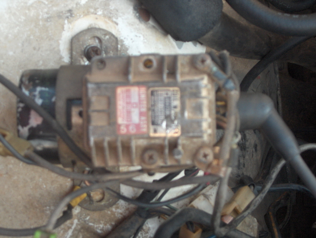

PostPosted: Mon Sep 22, 2008 6:22 pm
On mine the black w/ green stripe goes to the +, Blk w/ red stripe goes to -, blk. w/ yellow stripe goes to the wire from the igniter with a green connector. I have a wire from the igniter w/ a white connector on it I left loose, and the long wire from the igniter body to ground. Hope this helps

Still not working. This is what I have
From ignitor on new coil
- Red/White Goes to dist with plug
- Faded Red wire with green connector (which I cut off to hook up to something)
- Black (assuming neg)
- On top of the ignitor is a Black wire that goes to Neg on Batt.
From Truck
-Black with yellow
-Black with Light Blue or black with Green like the Haynes manual says
-Two Red and blacks - one near battery other conneted to solenoid
-Another black??
Some one please....
I have received directions in two different ways to hook these up and I can't get em right
My buddy,Bud Light and I have tried all combos and still no spark....
Any ideas?!
