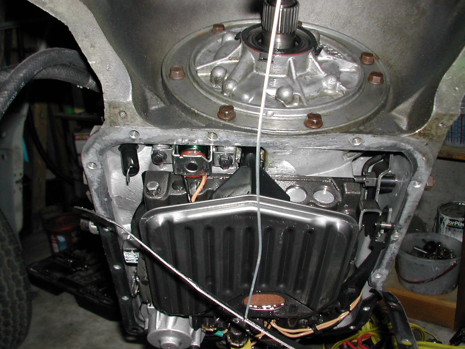

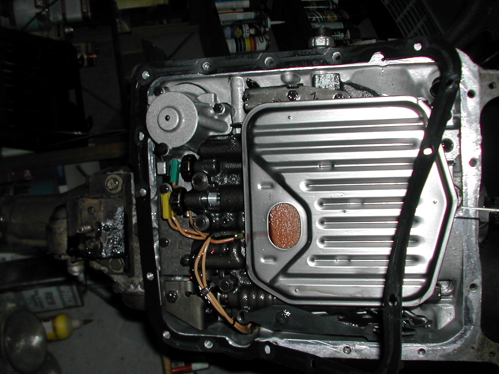

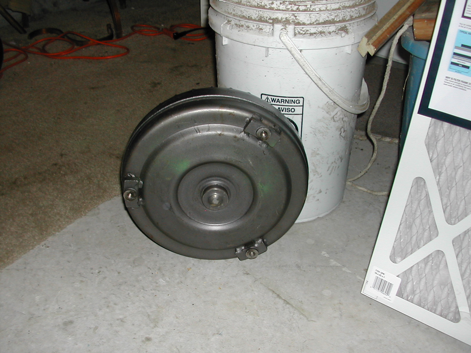

ok here is some pics/ I guess it is a lockup since it has the wiring right. Do I need to run a toggle switch if I want to lock it manually in a gear. will they work without a switch.

The trans looks like new and that is a lockup converter. Yes you can wire the converter to a toggle switch and lock it up when you want.
