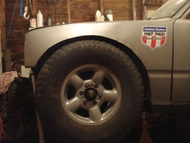

PostPosted: Thu Feb 04, 2010 8:56 pm
Joined: Mon Nov 23, 2009 9:02 pm
Posts: 40
Location: Boise,ID
305/70R16s are too big, but I like stock Rodeo steel wheels with 235/75R15s. I ran them on my 81 2wd with minor rubbing before I cut my fenders, should fit a 4wd even better.
