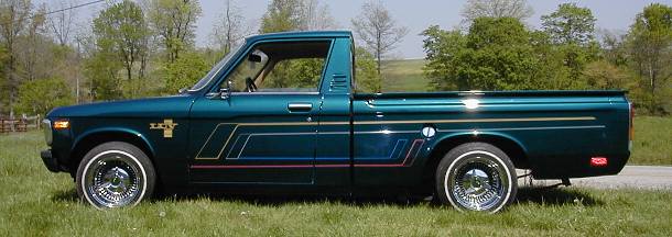

Hey guys. New to the site. I have a 1979 luv truck with the original 1.9liter engine and trans in it. I drove it in high school and have kept it in a garage ever since. When i put it away something under the valve cover was clinking. It had been rebuilt once before and i wasnt sure of the problem. Anyway, now i want to drive it again. And i want to know the easiest way to make it dependable and have decent gas mileage. I'm looking for an easy swap. Like an S-10 motor. Thanks for your help.

Nice lookin LUV!!!
Welcome :D
If you're looking for dependability and fuel mileage,I would fix the original drivetrain,especially if it's half as clean as the body seems to be.
