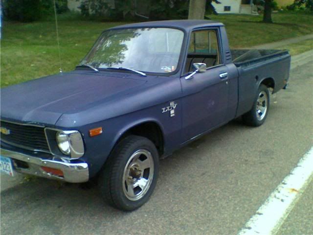

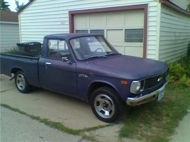

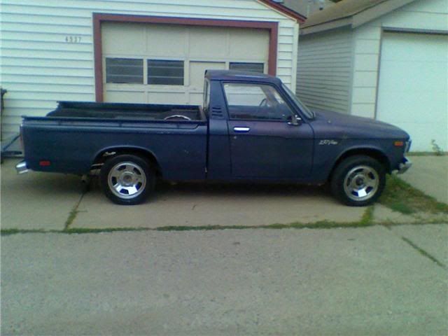

Here are the pictures as promised. I think it looks pretty good.

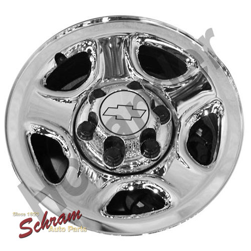

This is the rims I am running. they are from a 2000 Silverado 16" not sure about the backspace or width but they tuck under the fenders with about an inch from the outside fender lip and do not rub up front lock to lock with a 3" drop all the way around. I am running 215/65/16 which are less than an inch diffrence in diameter than stock tire size.
