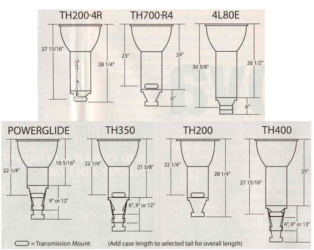

This might help too. I don't know if it covers every possibility. I have had it a good while. (That's redneck for a long time) :lol:
PostPosted: Tue Jul 22, 2008 5:15 pm
Another one
