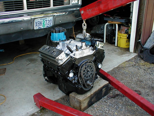

Picked up long block. Installed front & rear seals, new oil pump, oil pan, new intake, new valve covers, etc... New engine is in... Going to work on installing new carb, temp sensor, water pump and rest of accessories this weekend. Waiting for oil pump primer to arrive. Better get a new distributor cap & rotor also. Will post picture when finished.
75 Luv 350/TH350 (Project in progress)

Getting closer to completion...
PostPosted: Wed Jul 09, 2008 8:32 pm
Purty...
