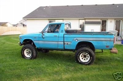

The only options you have is to fit the 4.56:1 pumpkins out of Pups or Troopers, or do a solid axel swap using a jeep or toyota axels.
1980 4x4 KBD40 ISUZU/Chev Luv
