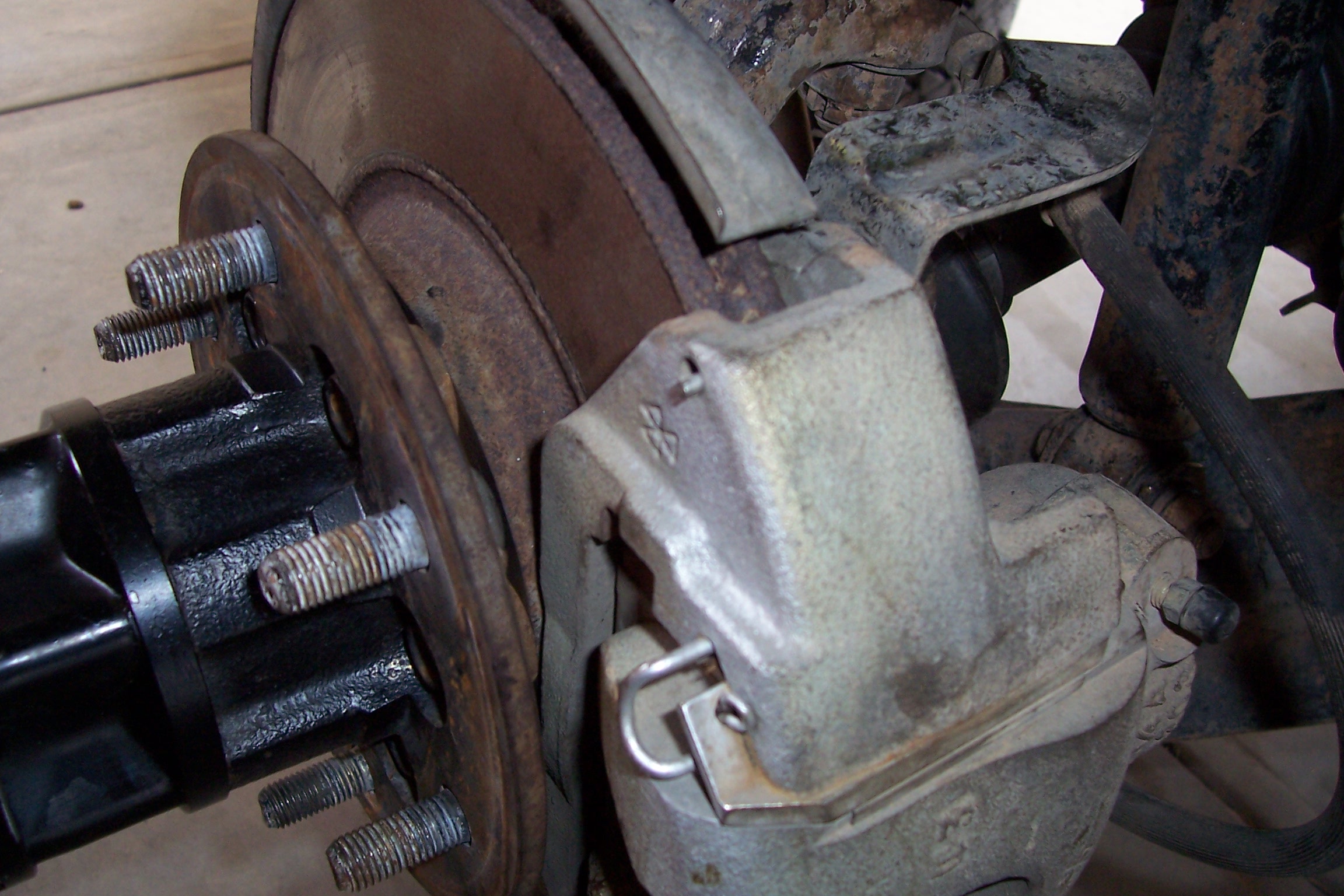

The discs,calipers and stub axels out of 81 Holden Rodeo's and early Holden Jackaroo,s are a bolt swap. Ive done a upgrade that uses vented Jackaroo rotors.
