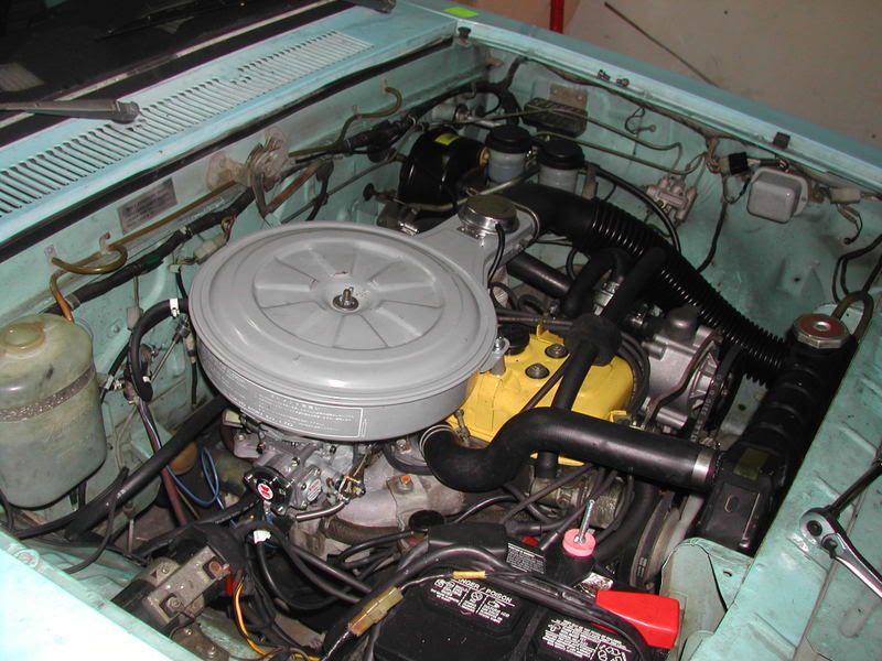

What set this off? The above thread, that the 34/34 dgec didn't have an adapter + time crunch to get smogged + Don't ever tell me it can't be done!!

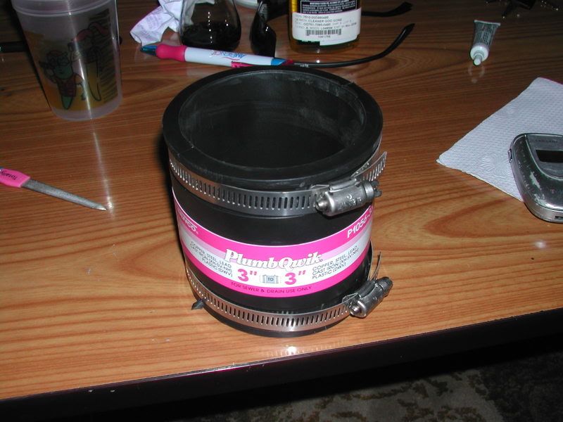

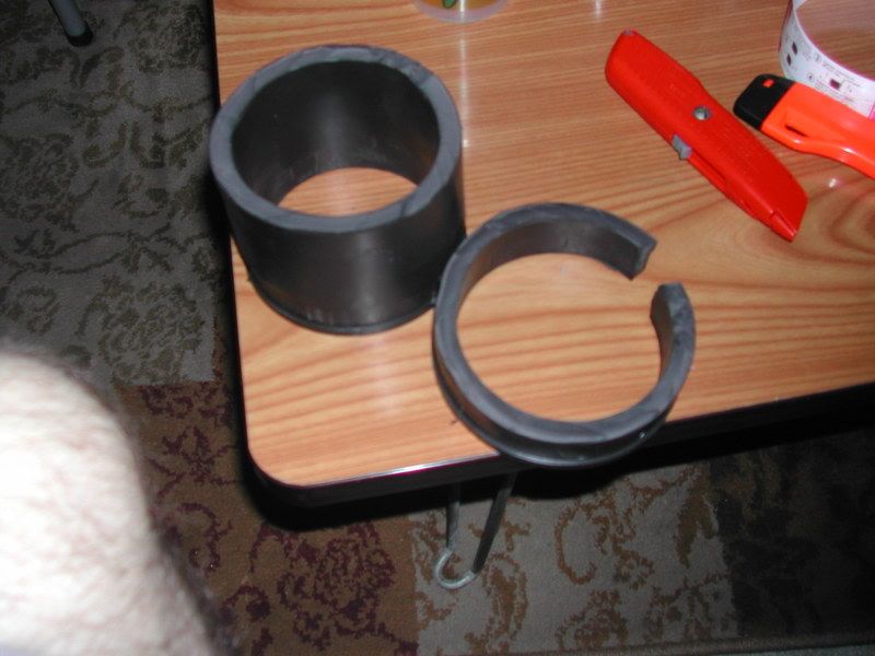

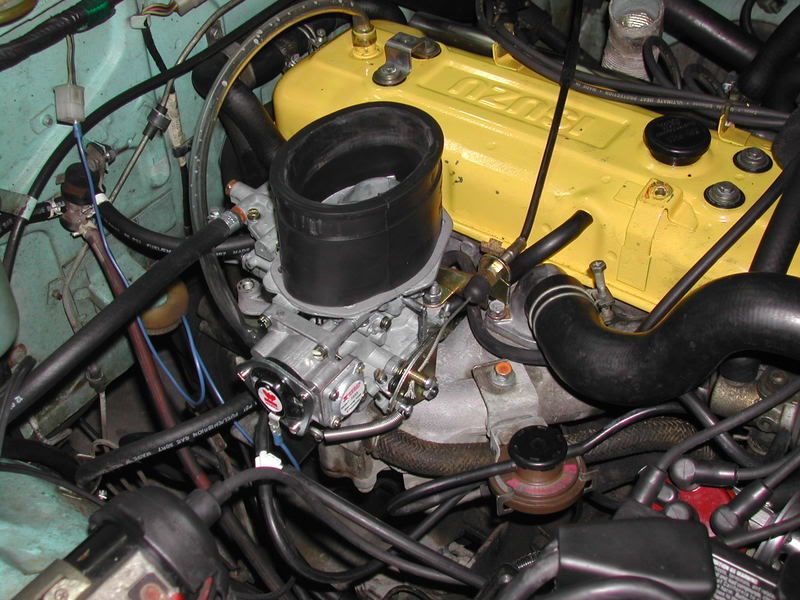

So started at home depot with a $5 PVC 3" to 3" rubber junction thingy

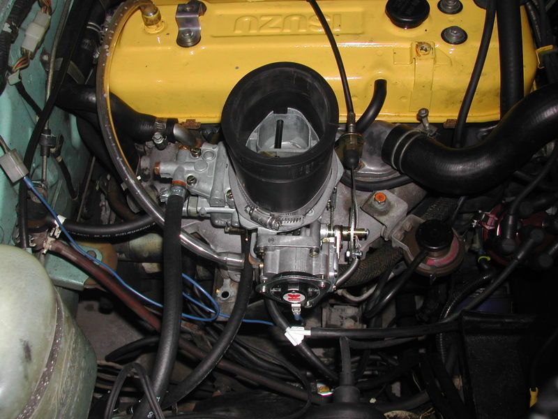

Original plan was to cut some of the bottom away and rubber cement some extra rubber to accomendate the oblong shape of the carb but to my surprise, the top of the 34/34 dgec although not round has an overall 3" diameter and rubber is flexible 1+1=2 right. After some initial sizing for hood clearance i took 1" of the coupler and fit again
No mods needed on the stock aircleaner

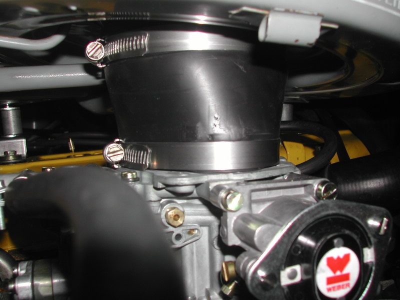

seals good without a clamp, even better with a clamp
some finishing adjustments

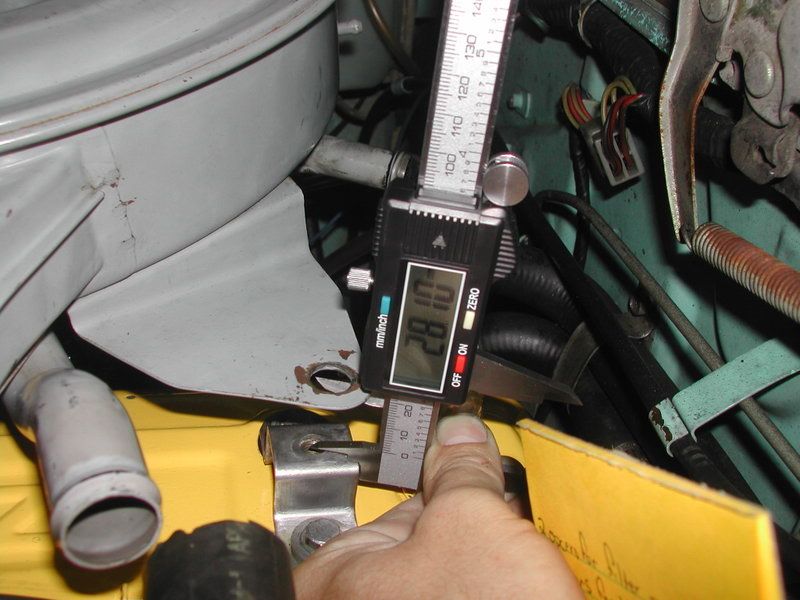

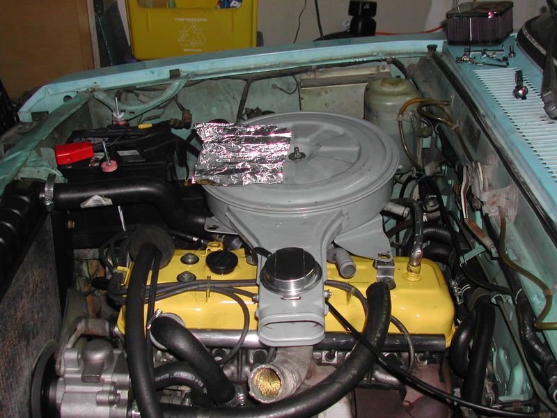

used the aluminum foil to check the clearance, Though it sat a little higher and less slanted than stock it had plenty of room left, the hood didn't even touch the foil

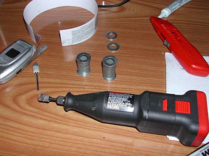

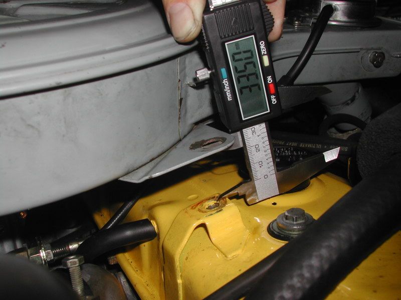

Measuring for some spacers

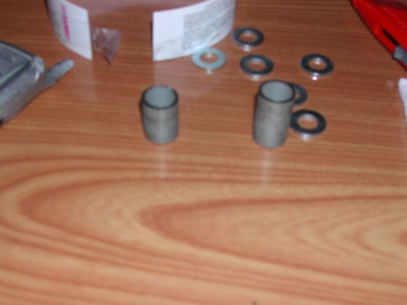

Spacer Factory made out of stock steel conduit or tubing

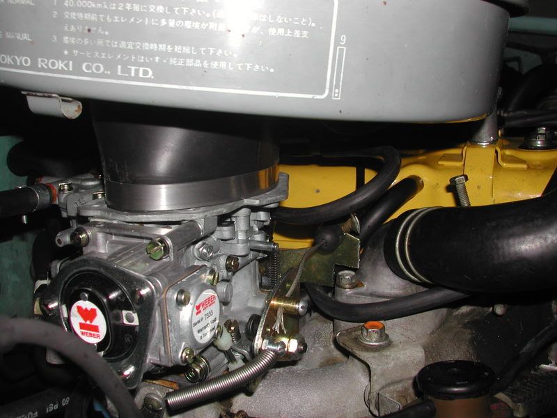

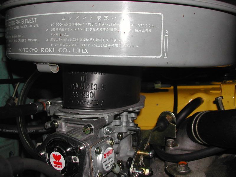

A little grinding on the forward screw bracket on the air cleaner was nescessary to accomondate the change in angle. The bolts i got were M8 1.25X60, They were too long. I'll get better ones tomorrow. there is no problem with the cleaner shifting because the hose clamps hold it snug.

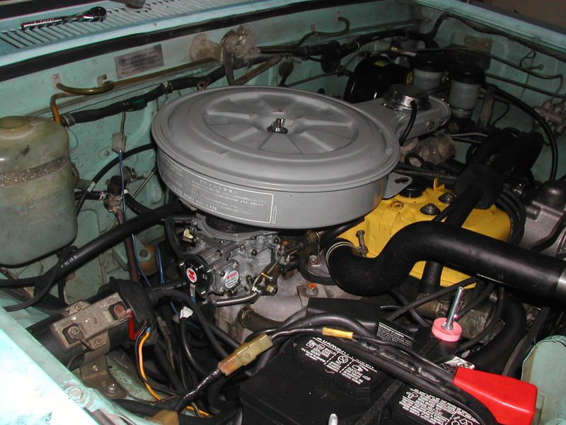

And viola, Weber you say, why I wonder what you are talking about silly smog machine operator dude.
A custom, sturdy, well spaced intake adapter for under $10 Not too shaby, did it in less than an hour total time(excluding naps, coffee, dinner, reading at LUVtruck.com)
What do you guys think? :D
Notes, this setup gives enough clearance for the choke valve to fully open.

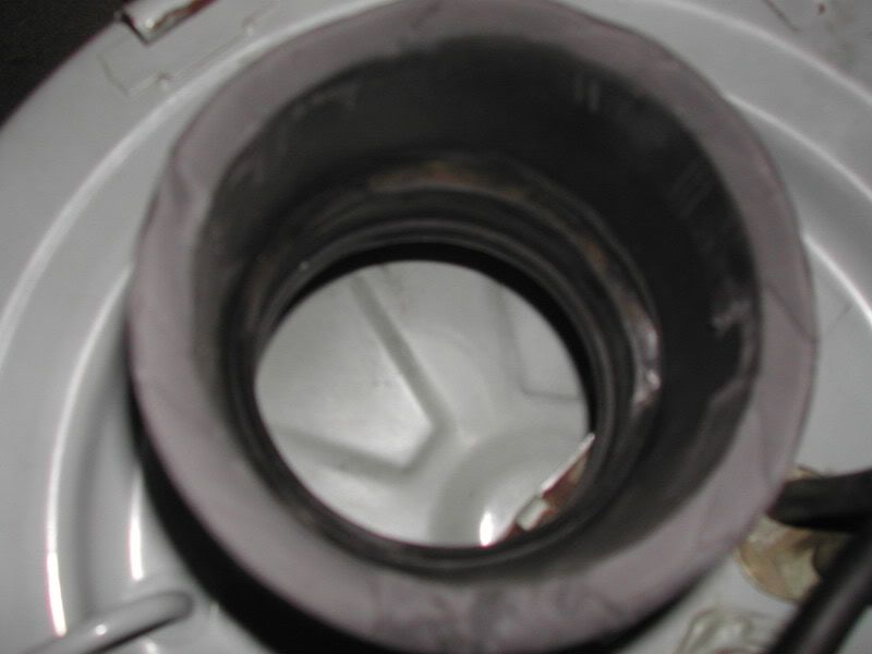

The rubber fit around the outside of the sotck aircleaner's bottom round tube instead of the inside diameter.
Tested and drove the LUV and there is a slight reduction in noise from the engine bay but i couldn't feel a difference in perfrmance. :idea:
