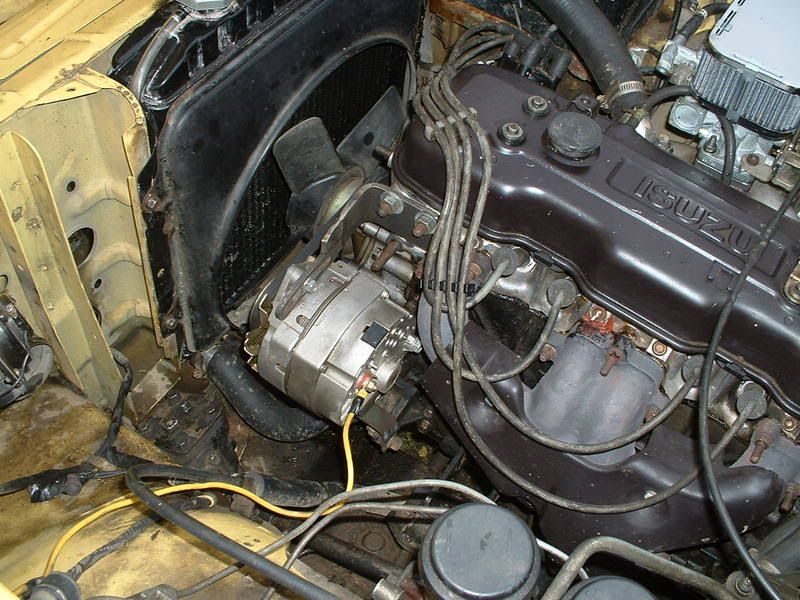

I had to make a new bracket for my internal regulated alt. by cutting the guide off the old bracket and bent some 2"x1/4" flat bar worked out perfect
picture below I didn't think I had a picture but here you go
