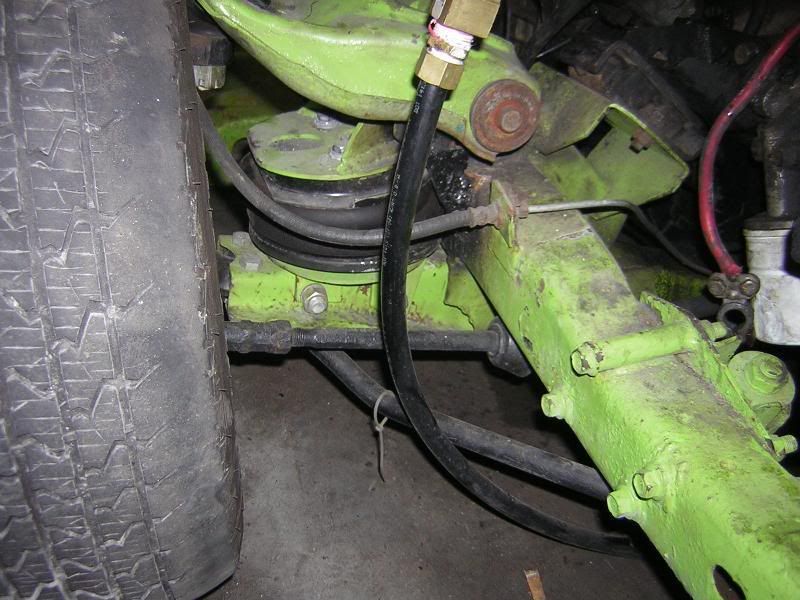

PostPosted: Thu Oct 19, 2006 6:59 am
Posts: 799
I was gunna say your a dumb arse but you already said it :wink:
That Pup you got there is bagged by the look of it. That tyre wear is shocking. lol.
