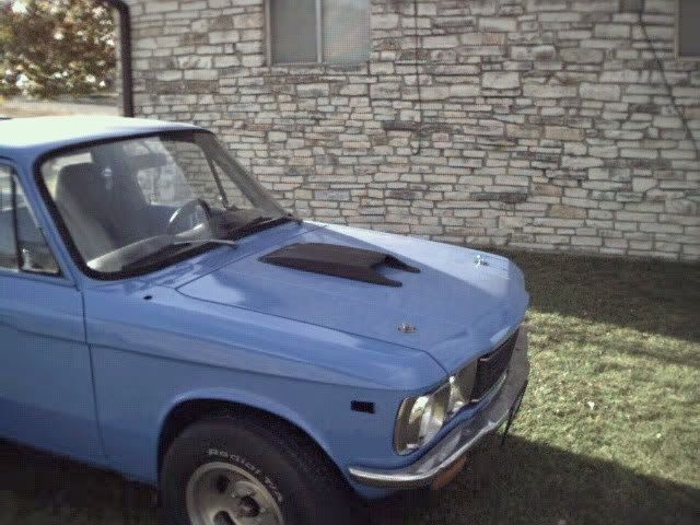

This is the scoop.

That's kinda what I was lookin at, only I was going to turn it around, thought it might let air flow through it better.

The thing is that the rear part of the scoop is wider than the front. With it turned around, it looks odd. But this hood is cracked and rusted. If it works out that the backward scoop gets rid of underhood temp, I'll go with the plan of getting a cowl induction hood.
PostPosted: Tue Aug 01, 2006 1:19 pm
Posts: 2013
This will bring up a new problem. If i run with the backward scoop, rain water will pour on to the aircleaner/motor. I guess i'll need to get the new hood as soon as possible.
