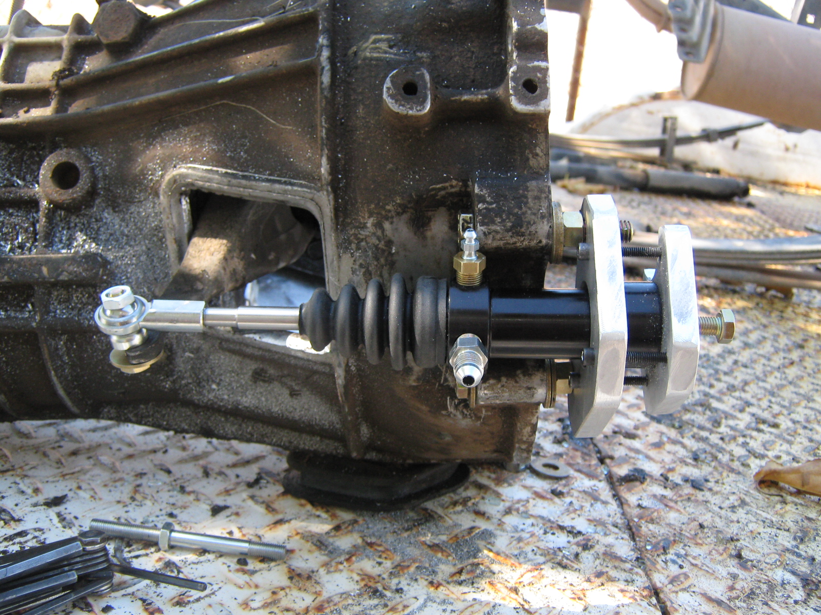

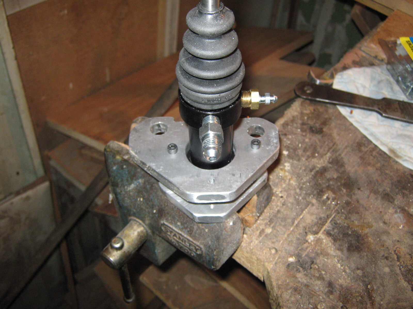

here are some pics of the bracket and slave cylinder.

Looks good.
Couple questions because I'm looking at doing the same thing soon.
1. Now that you have the freedom of placement that the hydralic slave offers, why did you change the fork to the passenger side? Wouldn't it have been easier to just install the cylinder where the clutch fork originally was?
2. What master cylinder are you using with this unit?
3. What are you going to mount the fixed end to? I'm anxious for your next pictures. :D
4. The specifications online show that this unit has a maximum extended length of 11.5". What is the minimum extended length? I'm trying to fit it between the existing bracket for the cable clutch and the clutch fork which is about 7".
Thanks,
Eric Q.

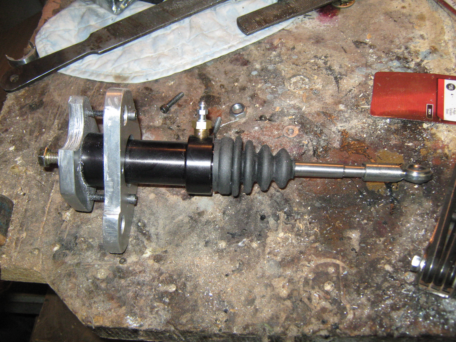

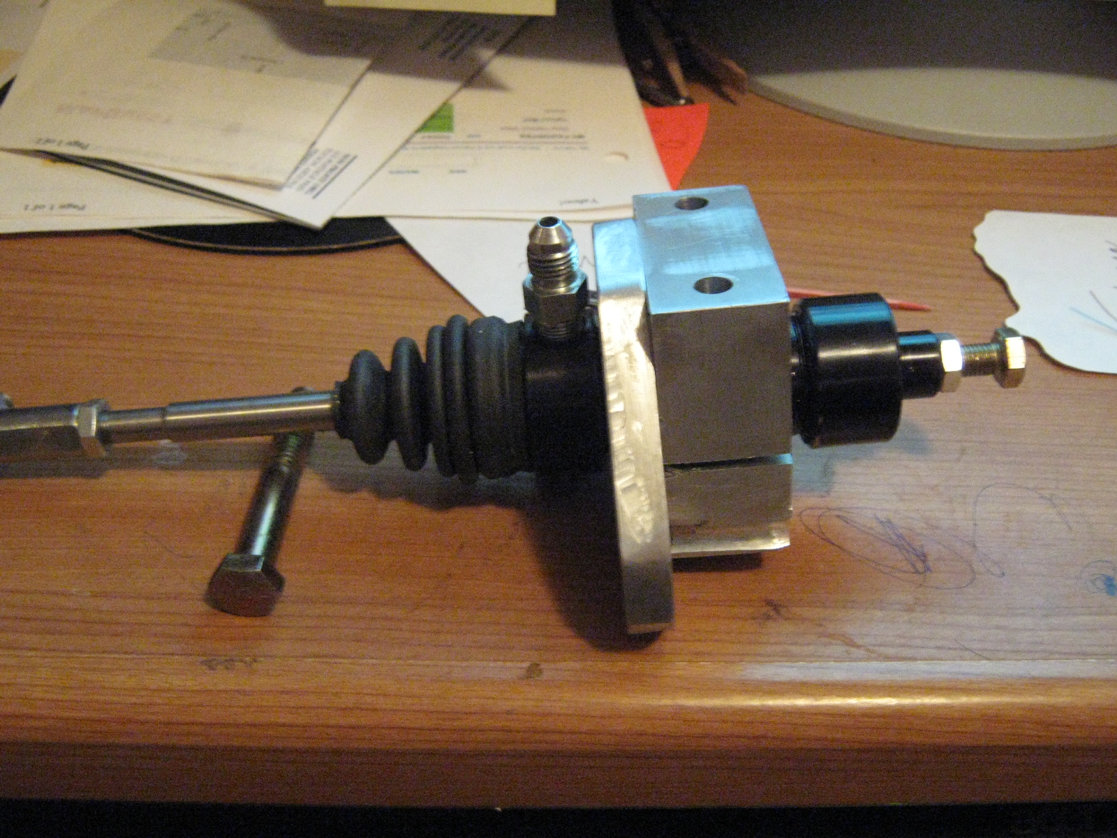

I DONT SEE WHY YOU COULD'NT KEEP IT ON THE DRIVERS SIDE. YOU WOULD HAVE TO REROUTE THE STOCK HYDRAULIC LINE. I'M GOING TO TRY THE STOCK 76 CLUTCH MASTER CYLINDER. THE REASON IS THAT I PUT IT ON THE PASSANGER SIDE THAT'S WHERE THE 76 IS. AS FOR MOUNTING IT'S GOING TO THE FRONT SIDE OF THE DUST PLATE WHERE THE STOCK SLAVE CYLINDER WOULD MOUNT. HERE IS MOCK UP OF THE MOUNTING THE SLAVE CYLINDER COMES WITH A ROD ( IT 'S IN THE PIC ON THE TABLE) THAT CAN BE REPLACED BY A SHORT 5/16 FINE THREAD BOLD AT THE FRONT OF THE SLAVE CYLINDER. UPDATE.... BOLTED THE TRANNY TO THE OLD ENGINE TO CHECK OUT THE THROW AND I HAVE TO PUT SOME SPACERS ABOUT 1" 1/2 ...

Nice looking fabrication work.
That totally makes sense.
Cool. That will shorten it down a lot. What is the purpose of the rod? Is it meant as a mounting point? From the pictures, it doesn't look as though you are making use of it. Or maybe I'm just not seeing it.
I was wondering about this. The stock clutch master cylinder is a 5/8" bore and has 1.25" throw. The stock slave cylinder is 3/4" bore so I assume it will have a throw of less than 1.25".
How much throw is generally required to engage a clutch?
Good luck and keep the pictures and updates coming.
Eric Q.

eric, i think you really only need about 1" throw for the clutch to ingage. as for the 5/16 bolt ,that would be used as a fixed point. i made my own and the 5/16 bolt does not serve any purpose,but to plug the hole . i put a locking nut on the bolt . if i have to, i will put a different master cylinder on it, one with more volume. i.e. 7/8 or 1" . Also check out speedwaymotors.com they have pull style for less and in different bore sizes. i keep you informed on the progress of this. Lastly i have a ideal about mounting a different way. l let you know on that, it will be cleaner .....AZDUDE

here is a pic of the second try. it's ajustable (1/4") and mounts to the front side of the trans

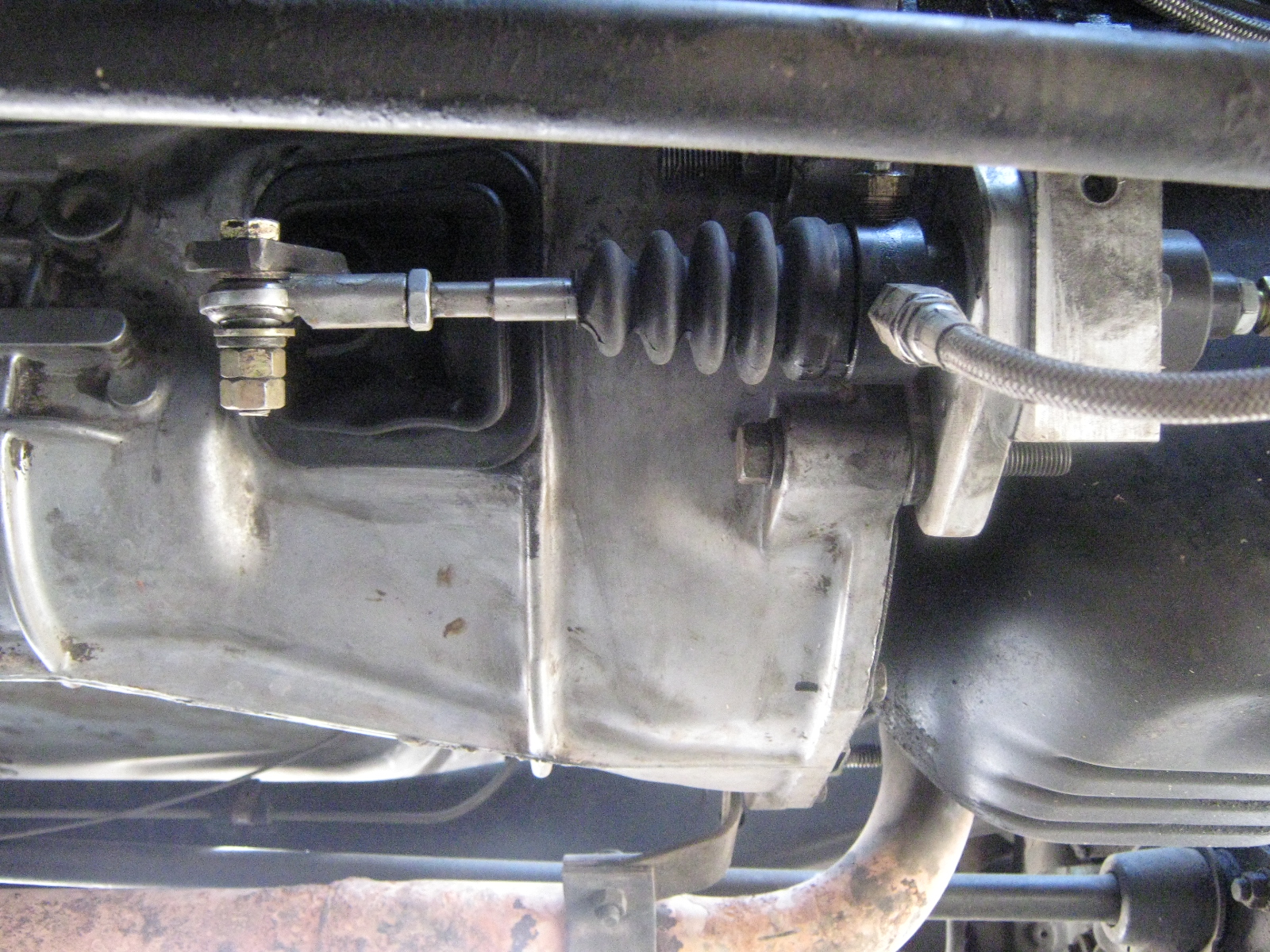

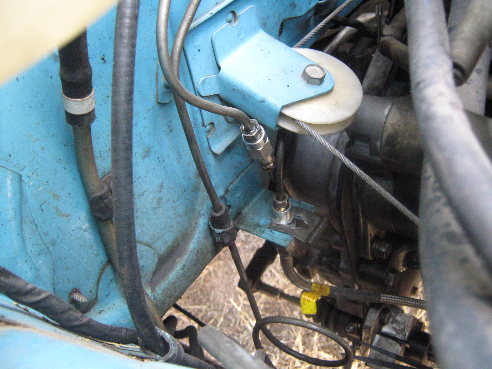

here are some pic of the finished 5 speed swap
