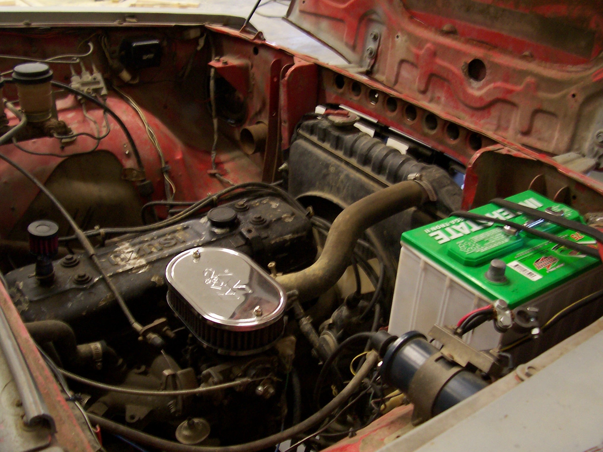

lets talk vaccum lines and weber carbs for a minute. I'm dealing with a luv that has a stock motor, weber carb, and a very confusing and incomplete vaccum system. can anyone give me a simplified vaccum diagram, with some pictures PLEASE. I'm just not luv'n the powerless thing right now, and I think some vaccum help would be in order. I still have the original vaccum diagram on the inside of the hood. but things under the hood aren't the same as they were in 1979
File comment: help me I'm helpless G180 !!!
Juice

viewtopic.php?f=6&t=17063&start=20
Maybe this will help. It's been almost a year since I installed the Weber and it's running strong as ever. I know I said earlier in this thread I would check things out later in the summer, but I forgot about it. This way of connecting the vacuum lines was just common sense to me and although there were doubters claiming it would lead to disaster, they have been proven wrong.
I just got my license tabs for another year...almost 20,000 miles on my LUV so far!!!!
