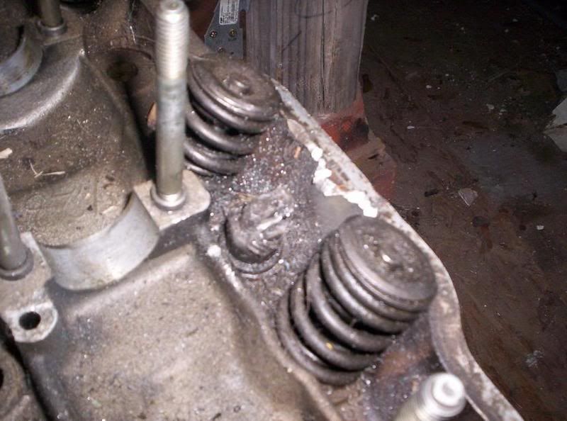

the g180 engine
the goobered head bolt on the g180
and my other g180 head with the bent valves

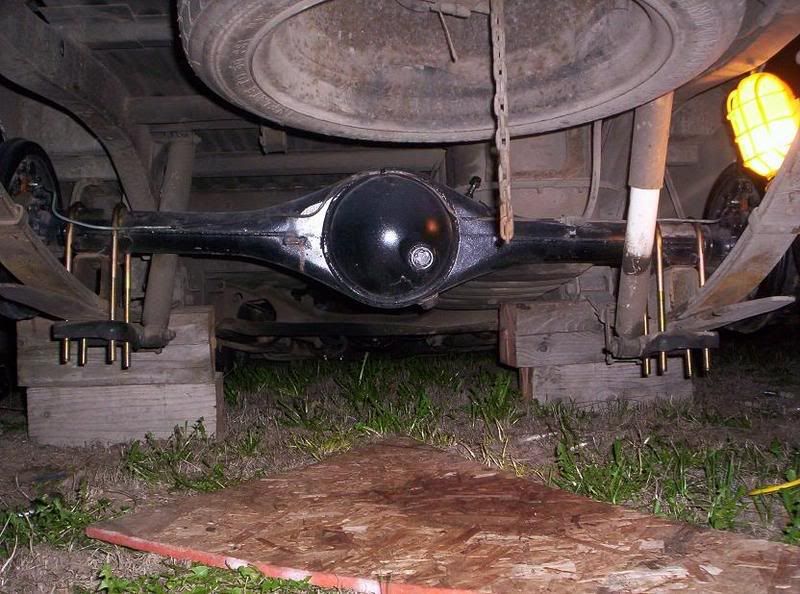

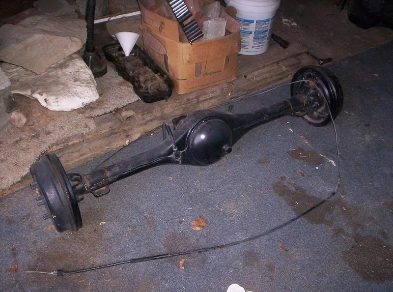

i got the new rearend in the truck tonite. its all nice and clean, and the rest of the truck is all greasy. lol
heres some new pics...
new u-bolts

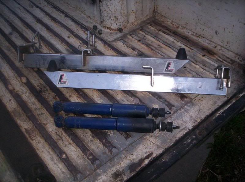

got some more parts. hand-me-downs kick ass!!
i got the slapper bars, and a set of front shocks from cody's (luvontherocks) luv. he doesnt need either of them anymore due to him ladder bar-ing, and coil-overing his luv.
so free parts are always good.
im also going to be pullin the engine today.
i though about starting it up for one last time today, but i didnt wanna swap all the parts from the luv back onto it.
anyways, heres a pic of the newly acquired parts...
ill have pics of the engine pull later on.

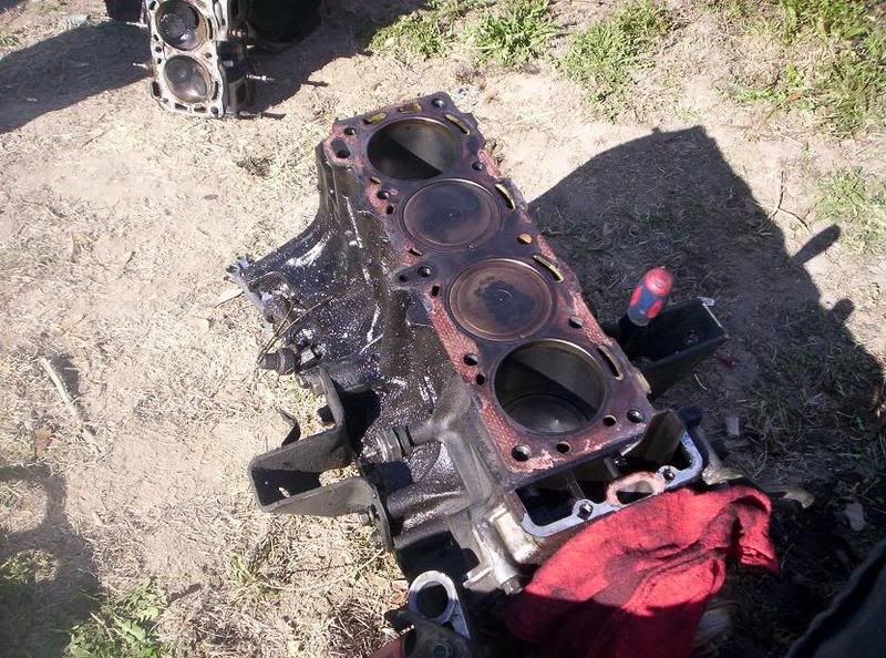

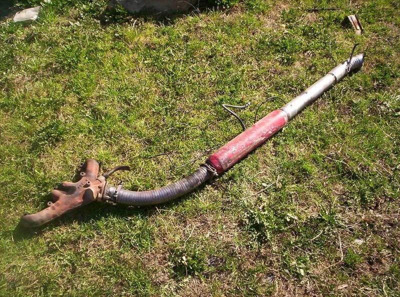

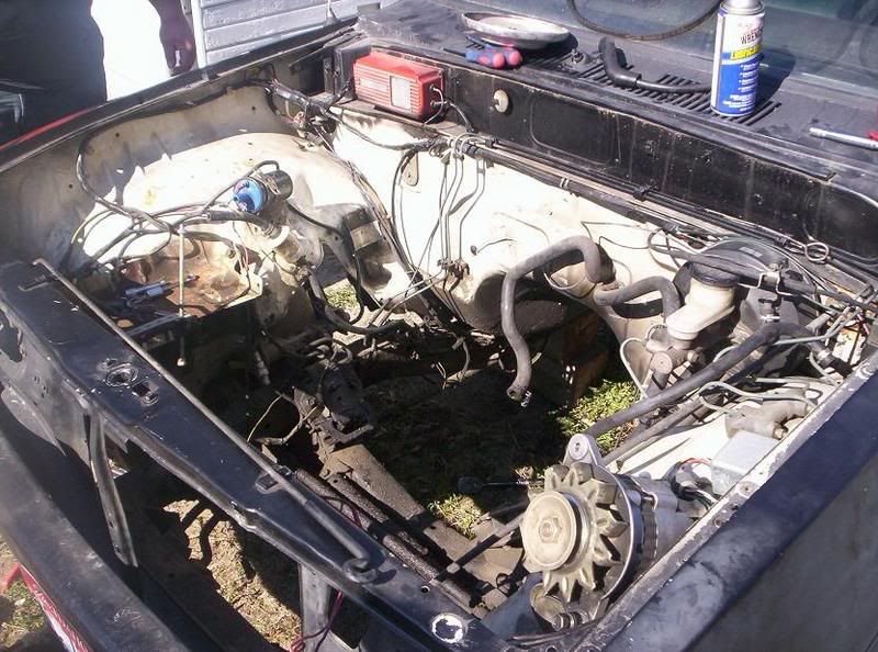

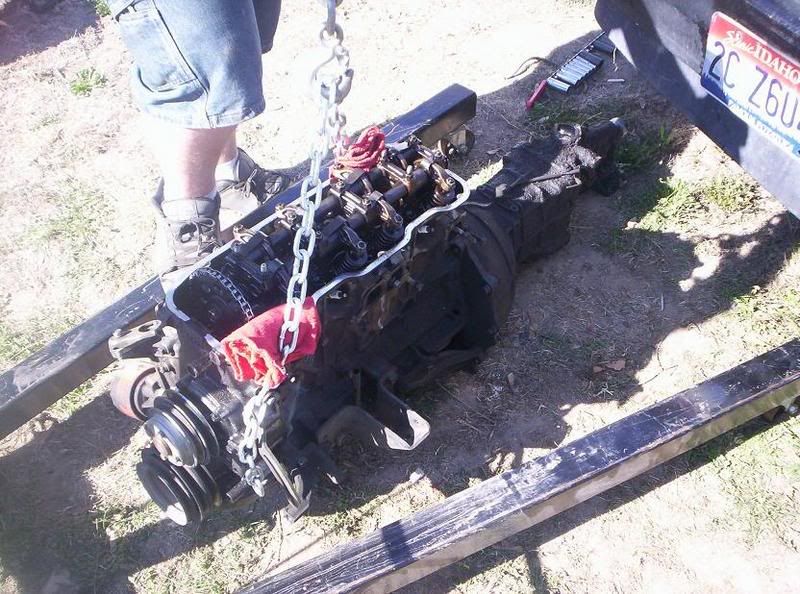

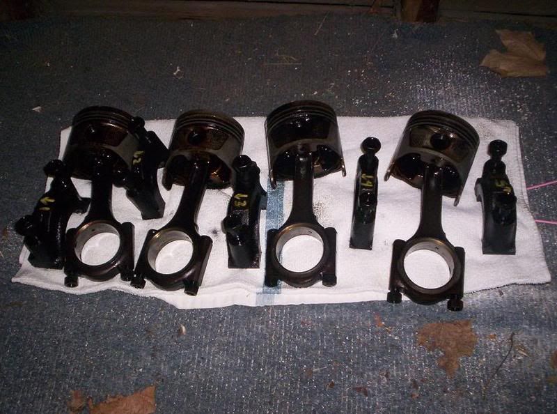

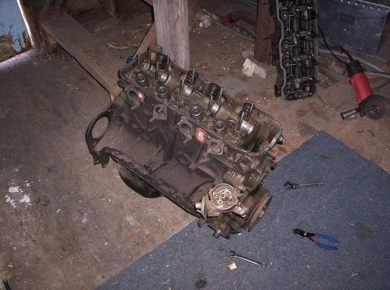

got the engine out. seems it gets easier every time.
only took like 2 hours to do, but i was screwin around about 75% of the time.
anyways, all went well. no broken parts on the truck or the people pullin the motor.
i did take some of the engine apart.

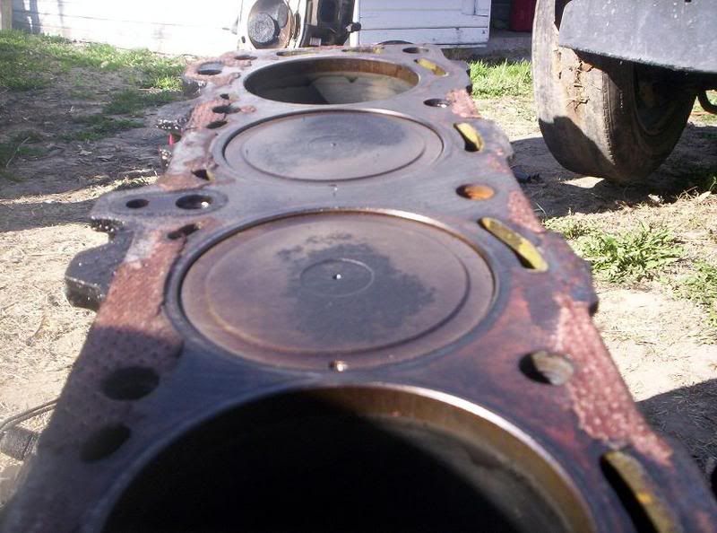

its got slightly domed pistons in it. they also have "A"s and "B"s stamped into the tops of them.
the cylinders look abosolutly fabulous too!! on some of the cylinders you can still see some crosshatching.
i only took the head off, so i dont know about the rest of the engine. i have to get bolts for the engine stand tomorrow, and then i can tear it the rest of the way down.
things are lookin good for this engine!!
heres the pics...
the exhaust i had on the pup. it did sound pretty good! lol
see the dome
the head looks good too. im gonna see how much itll cost to put g200 valves in the g180 head.
im gonna go to the machine shop tomorrow during my lunch and see how much this all is going to cost me.
ill get more pictures of the inside of the engine tomorrow.

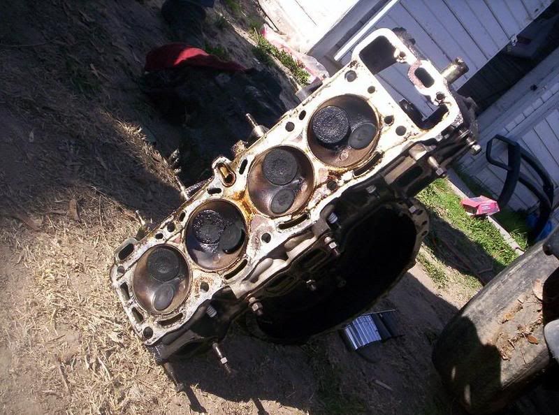

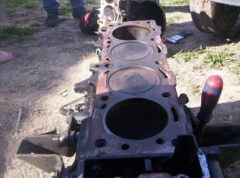

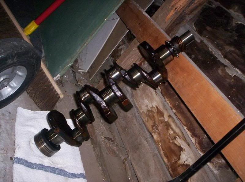

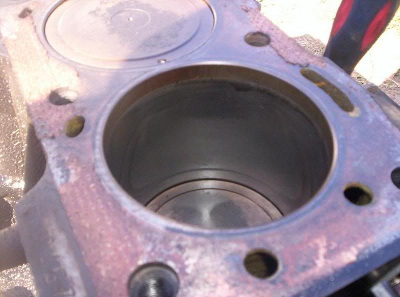

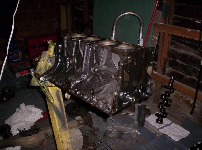

the motors apart now.
everything checks out good.

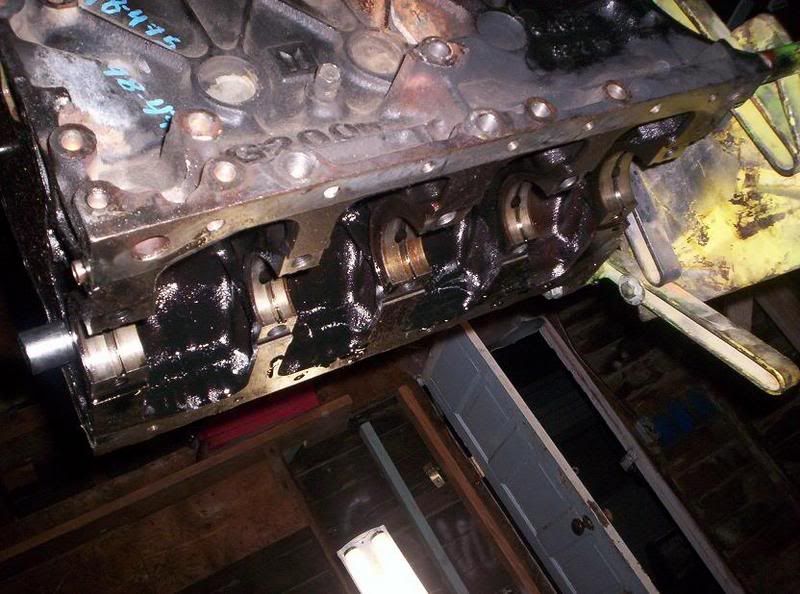

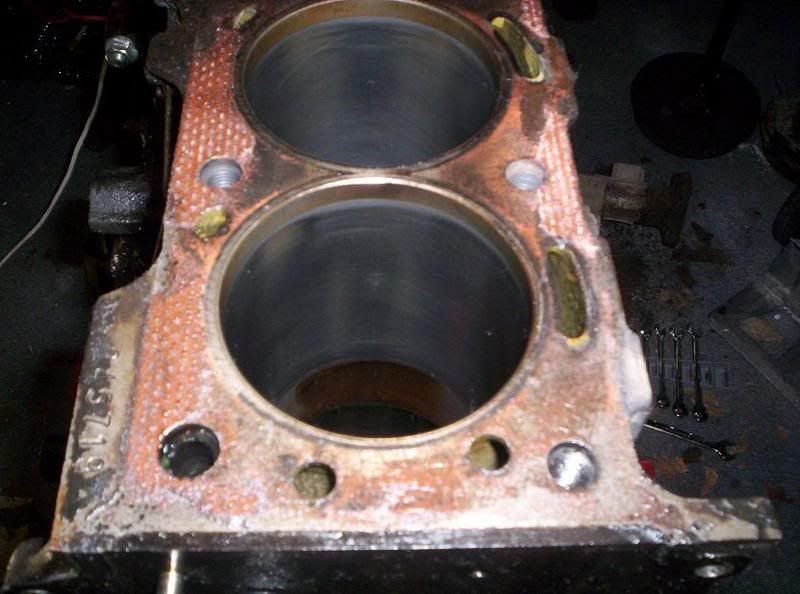

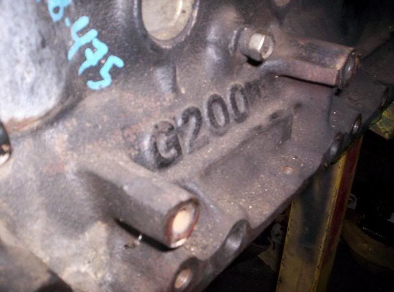

there was some scoring on the rod bearings, but the way the oil had some metal in it, im not surprised. the mains looks great though!!
the cylinders also look great. you can still see stock crosshatching in some of them.
the pistons are good too. one had a tiny bit of scoring on one skirt, but it isnt anything to worry about.
the crank looks okay. the mains are good, but the rod journals are gonna need polished.
no horrible damage was found in the motor. its gonna need a new timing chain and guides, but thats a given on something like this.
anyways, here some pictures...
see the crosshatching...
yup, it must be a g200...

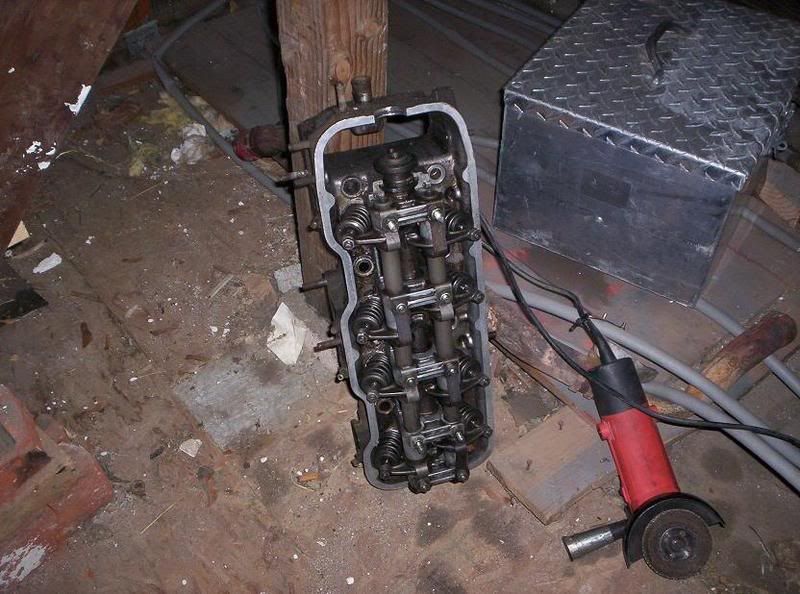

the motor is still being rebuilt, but not like id planned on. im going to clean the block, hone the cylinders, clean up the deck, emory cloth the crank, and put it back together. im going to use the g200 head that came off of it again also.
then im going to run the stock intake with a weber, and ill use the header that i picked up. thats about the extremest im gonna go on the engine.
since im doin it this way, i can just start cleanin everything back up right now. i know this isnt what is considered 'right', but its really all i can do now.

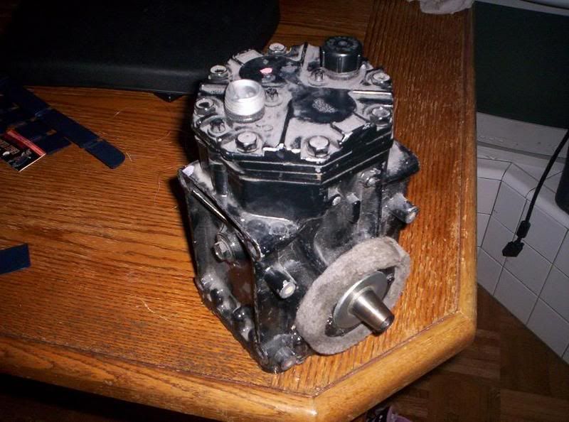

ive also decided on another thing. some of you might know what im gonna do just by seeing this pic...
yes, that is a york 210 air compressor. and yes, the pup is going to get bagged.
now the bags wont be until we get in the next house, but the truck will be up and running hopefully by this time next month.
PostPosted: Thu Mar 29, 2007 12:09 am
Swap Specialist Mod
Posts: 2831
mkay. i made some progress tonite.
the block, head, and timing cover have been degreased. the block is ready for paint almost. i need to get the gaskets from the timing cover off the block still. then it going to be painted a dark grey or somethin.
the head still needs a little SOS work done to it, but its done for the most part.
the timing cover need an SOS job real bad, but my buddy is gonna work on that while i polish the crank journals.
the block is also ready for the crank to be put back in. i need to hone it and rinse it off one last time, but thats it. im gonna set the crank in the block and go over the rod journals with some emory cloth. the crank isnt bad at all, so this will be fine.
the pistons are probably going to have to wait to go in till next week. im running low on money right now, and dont get paid till monday. that and i need to by a torque wrench, ring compressor, and find my feeler guage again.
so, things are still going okay.
ill get some pictures tomorrow.
