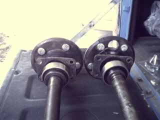

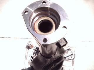

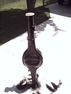

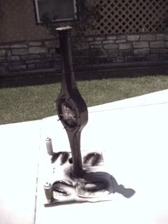

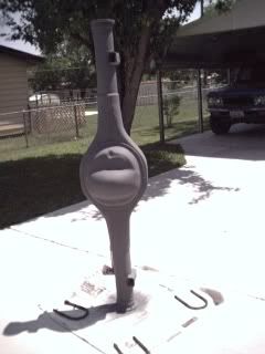

Here's some pics of the rework assy
Image Rust killer primer coated
ImageImageFresh paint
Moser housing ends with new axle seals
Brand new axle bearings.
Once the paint gets cured, i'll be putting it all back together.
