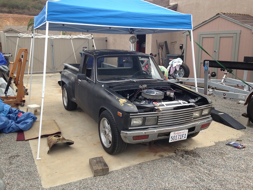

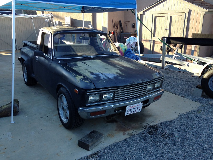

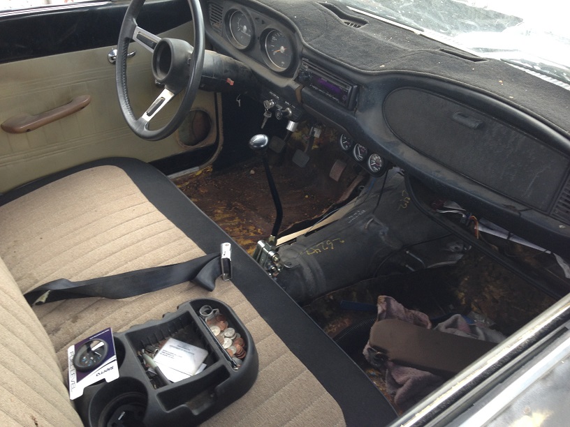

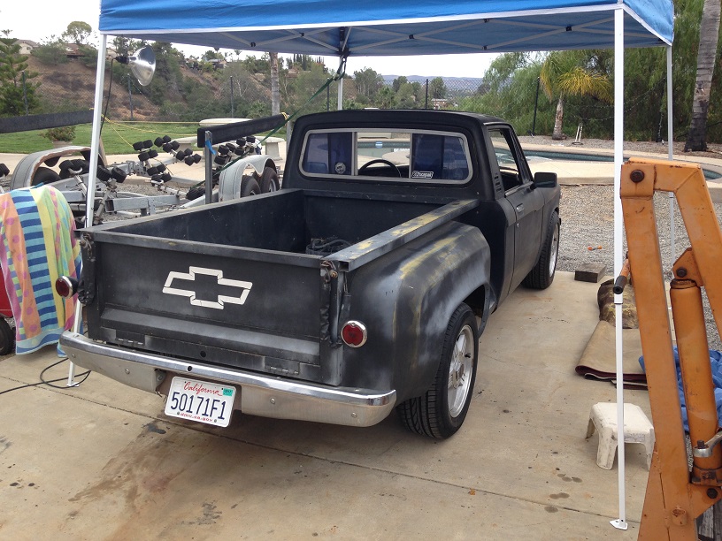

More testing and driving.
great running and driving little truck, its kinda loud...
now with safer brakes, new rear tires, fixed the diff cover leak.
Got rid of the bald 245/50/16 rear tires, new Ohtsu 225/55/16's for only $55.00 at discount tire.
ride great look good too, now they all match.
Used the rear Camaro inset wheels on the front, fronts on the back, works great.
Really fun to drive, shifts great now, lots of power cruises effortlessly...at 70-75.
Gas gauge, trans tunnel, exhaust, primer/paint to go...

as I mentioned before I bypassed the stock fuel gauge with a marine generic sender and a new sierra gauge.
I hooked up the gauge it works great, easy solution.
Gonna do the exhaust next week.
Trans tunnel being fabbed locally.
