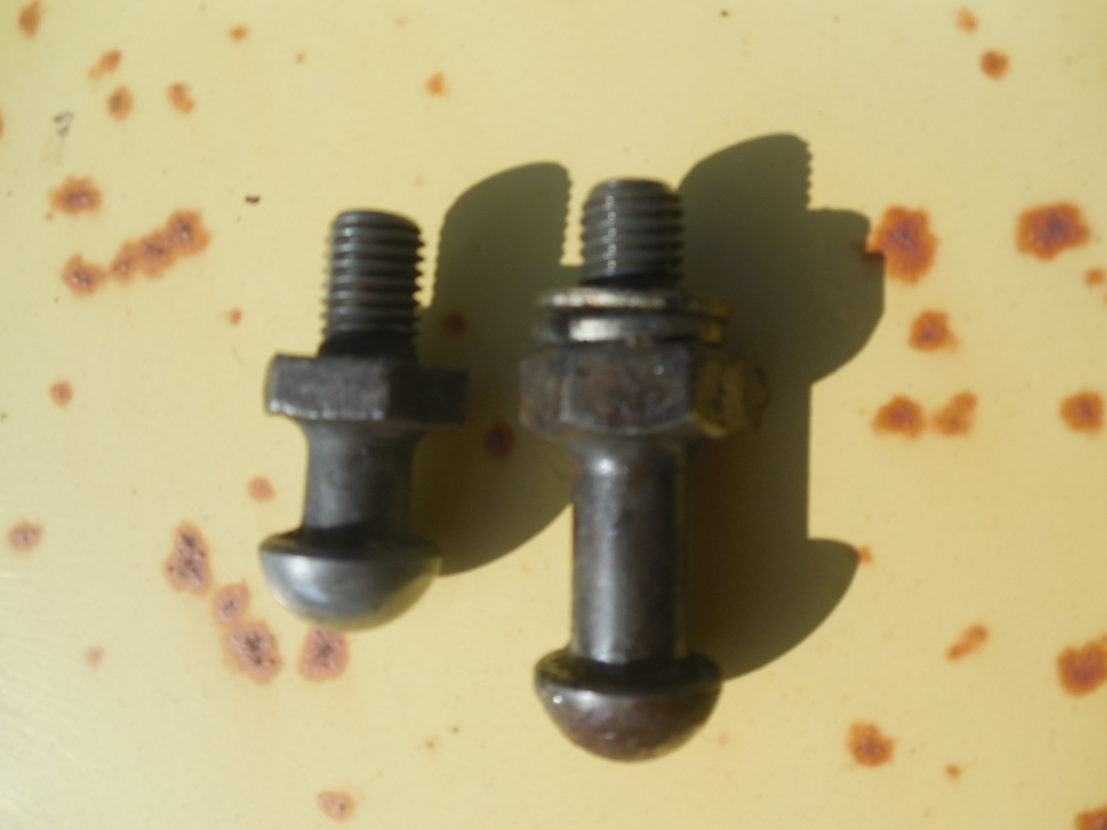

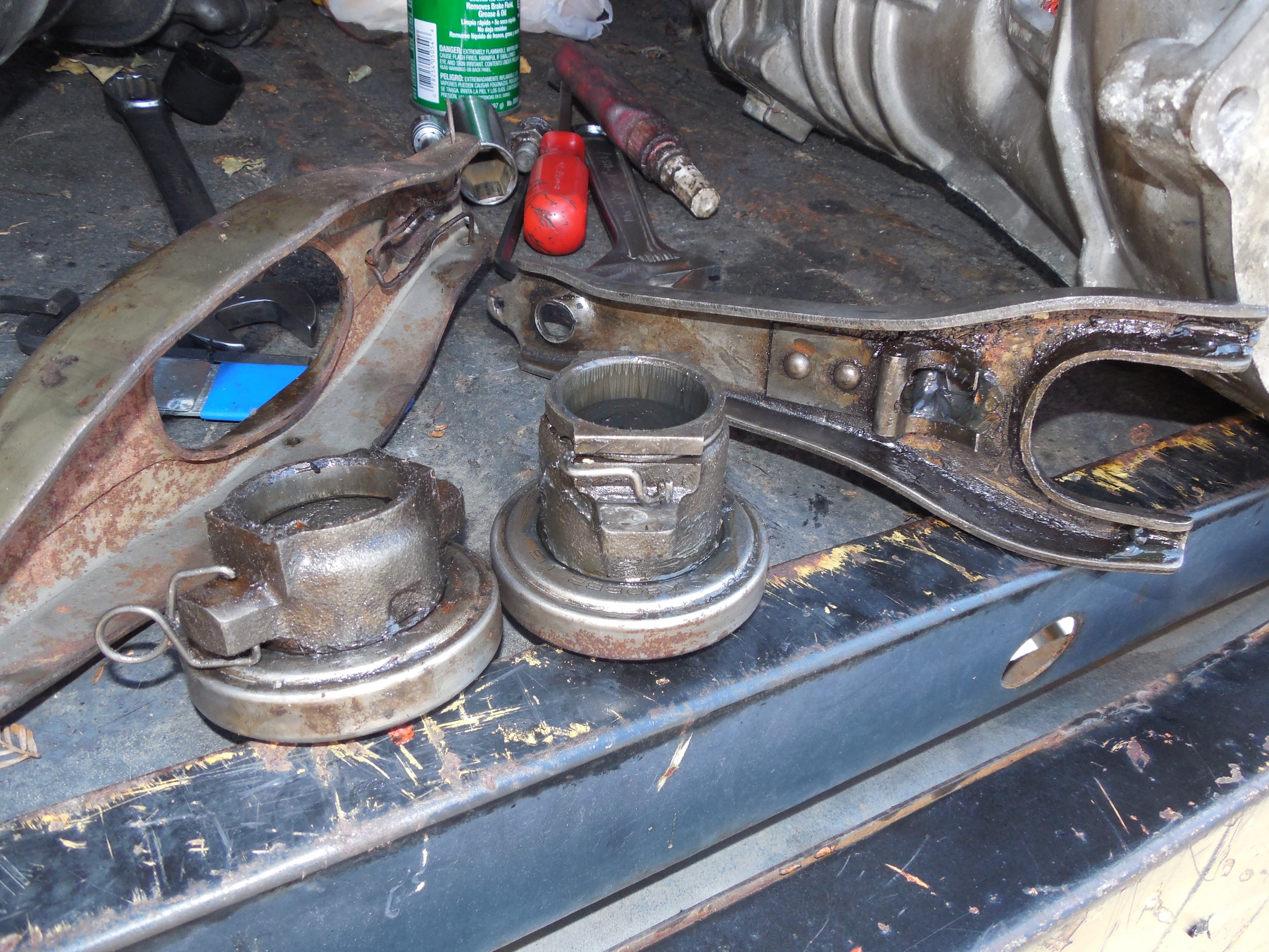

Are you sure the ball you installed is at the correct height?
when i swapped mine i notice 2 pivot balls heights....i used the short one
also the throw out bearing was in 2 different heights & i used the taller one in this pic...i also found that mine hung up in 1 spot & did not slide to freely so slight sanded the 2 surfaces & slight lubed the shaft so it would slide easier

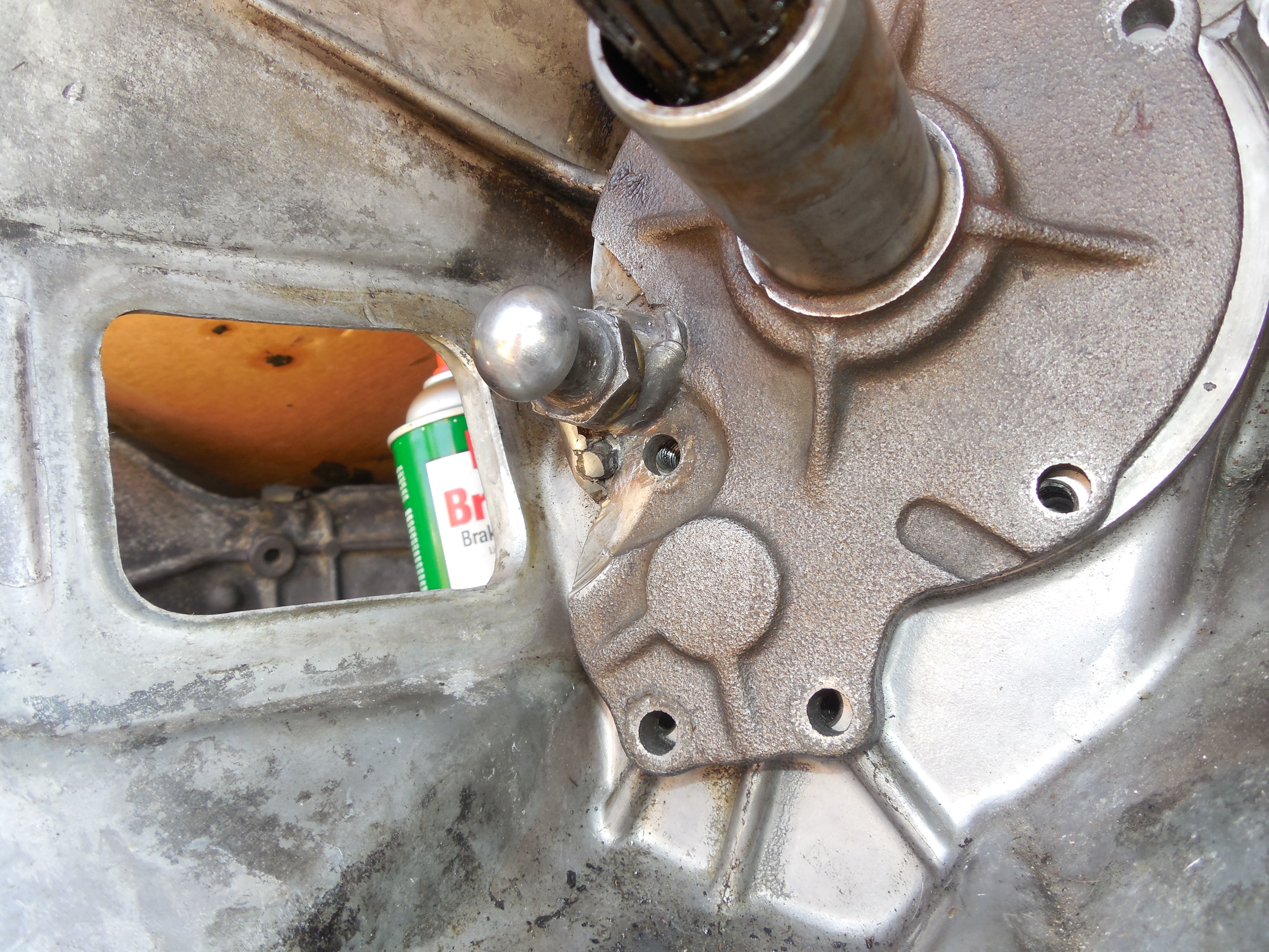

& last i came across another pic of my modification which i removed the pivot ball from the far side to the fork window side & welded a nut to the cover switching it from a cable clutch fork trans to work w/ my hydraulic clutch.

3rdLuvNext2a66MALIBU wrote:
Hey 3rdLuvNext2a66Malibu,what year was the transmission you swapped in? I mentioned earlier, when I did a similar swap, approximately 20years ago, I remember changing the pivot ball and it worked. I forget what year or vehicle I got the trans was from. On this swap, both pivots were the same size.
