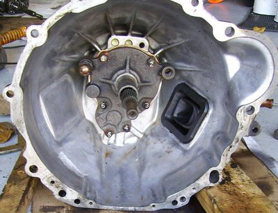

do you have a pic of this so i know what to look for? thanks!!!

jerryfreak wrote:
JoeIsuzu wrote:
I don't understand the question. The '87 is the same as '86. The diesel bellhousing can come from any diesel 5-speed '81-'87, and even SOME 4-speeds as long as they have the six bolt bearing retainer in the bell housing.
A pic of what? A diesel bell housing? Or the bearing retainer?

bearing retainer please
Here's a photo of the 6-bolt bearing retainer in a diesel bell housing. However, you may not be able to see all six bolts if the clutch fork is still attached.
