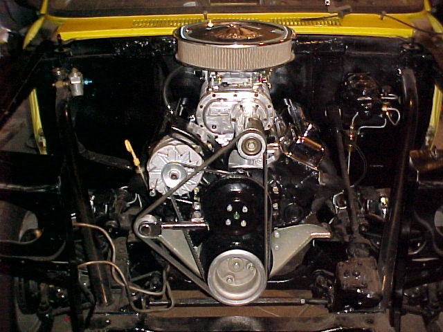

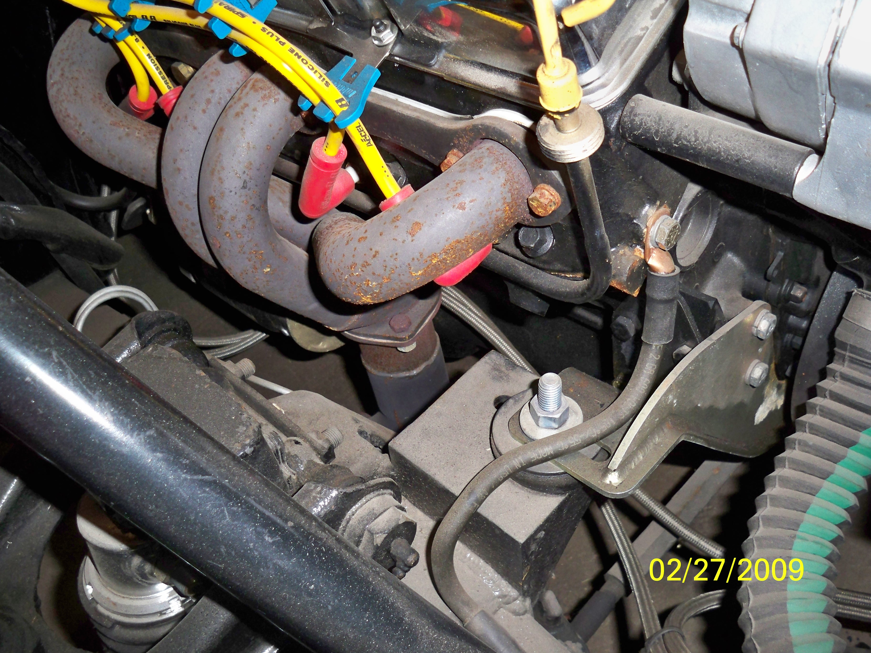

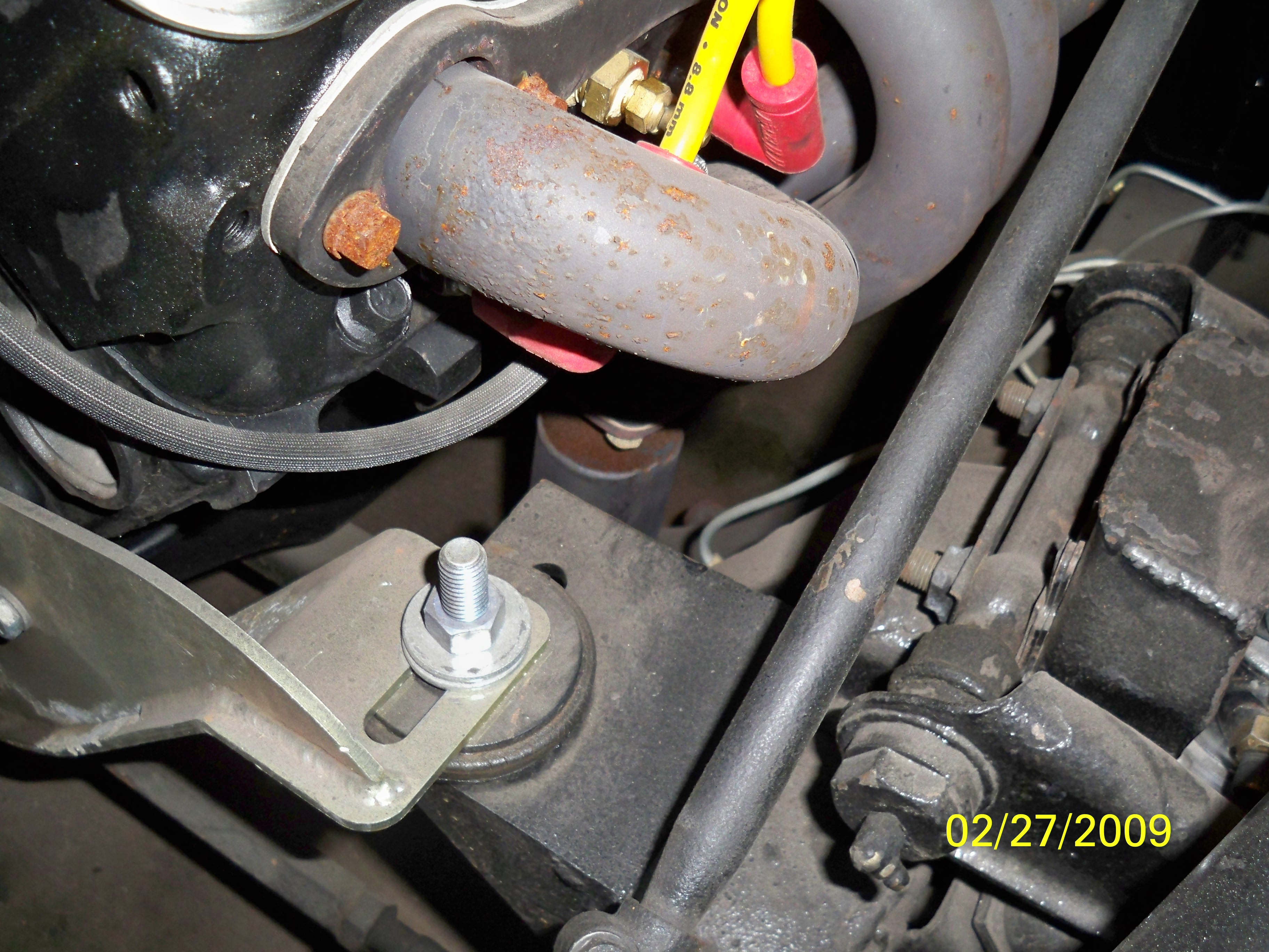

I am looking for at least 1 3/4" tubes that will clear my firewall I have plans to change the front mount to side, removing the block hugger headers, sb350 and 144 b&M blower and replacing with sb400 + and a Pro charger.

You've taken the torsion bars out. That should not be hard to find a 1 3/4 header to fit. Even custom could be done. I don't understand the significance of clearing the firewall. It should not be in play. Why change now to side mounts?

I did set the engine back and on a lot of headers the rear tube drops back to far and will hit the fire wall, as for as why I want to change to side mounts is because of transmission bell housing breakage. I really don't want to run a mid plate to stop the problem.
