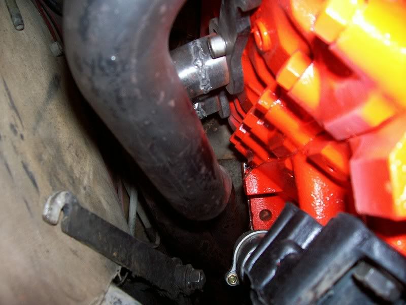

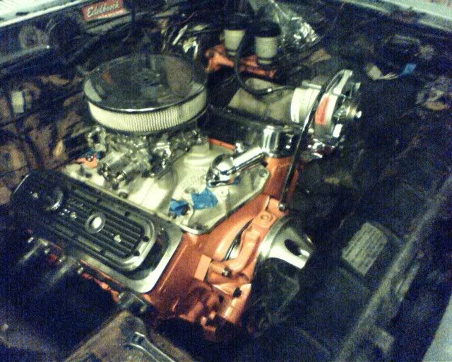

cb6tig1, seen the pictures you posted of your 4.3L with the Edelbrock intake manifold and carb. What are the model #'s of them. Might want to use them on the long block for the '86 GMC 4x4 that needs installed unless we opt for a 350?

the carb is a 600cfm its a little big the cam and intake combo. it calls for a 500cfm. but i seen 1 4.3 with a 600cfm it ran ok.
the intake i think its a 2114 i think off the top of my head.lol

i was not right on the intake its 2111 . not the 2114. sorry

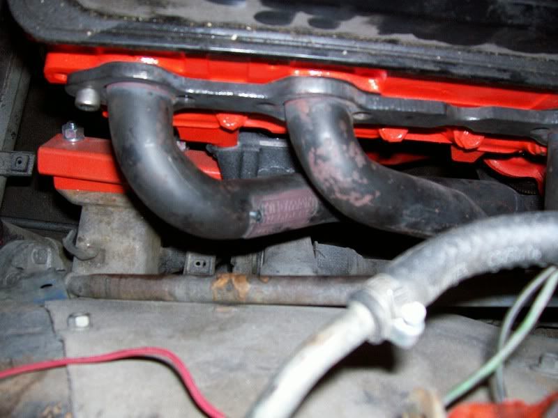

What headers are those? Are you running a 4 speed in it?

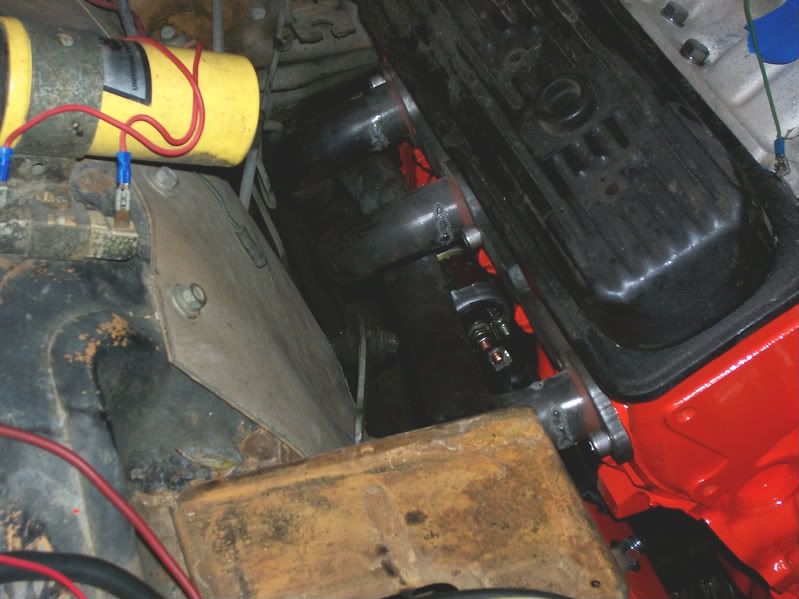

Hedman Street Hedders HED-69400
im running a 5speed from a chevy monza

The 2111 intake is for the non-vortec motor and the 2114 is for the vortec.
What dist. are you running?

dang...that looks nice in there

im running a HEI .
i still need to paint the fire wall and fenders

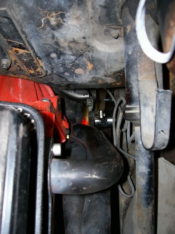

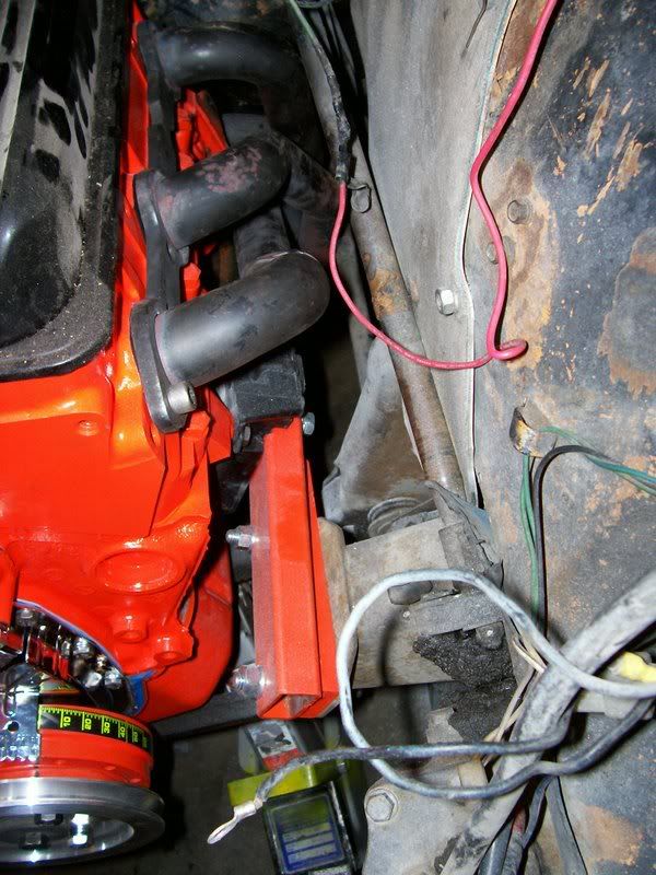

It looks very tight but did you have to modify anything to get it in there?
PostPosted: Sun Jun 29, 2008 11:30 pm
Posts: 773
Location: Caldwell ID
no mods to the truck. the headers had to be worked over some.

Very late on the scene here but I did a 4.3 TBI swap in my luv. No pictures at the moment, but it was fairly straight forward.
Tore the 1.8 out.
hacked off all motor mounts
put the 4.3 in.
marked where motor mounts should be mad
fabed motor mounts out of 5/16" plate: triangle shaped things which the mounts on the motor bolt up to.
Welded these up to frame
put motor in
cut hole in firewall, the TBI computer goes though it and sits below the pass. glovebox
Radiator needs to be changed around, running 16" push fan in front of radiator
Yeah...simple as can be. :roll: :roll:
The 4.3 will sit in the engine bay with no body lift at all. You'll have to ditch the pully driven fan though, I'm running an electric fan. Works fine.
You'll be able to mount a tranny of your choice behind the 4.3, also w/ no lift. I'm running a TH350, but I'm going to tear that out for a 700R4 in the next week or so.
I'm using the stock manifolds which came with the engine. They fit perfectly within the frame, no massaging necessary. Cut the factory Y pipe right after the O2 sensor and fabbed my own 2 1/2" exhaust which dumps behind the rear axle.
