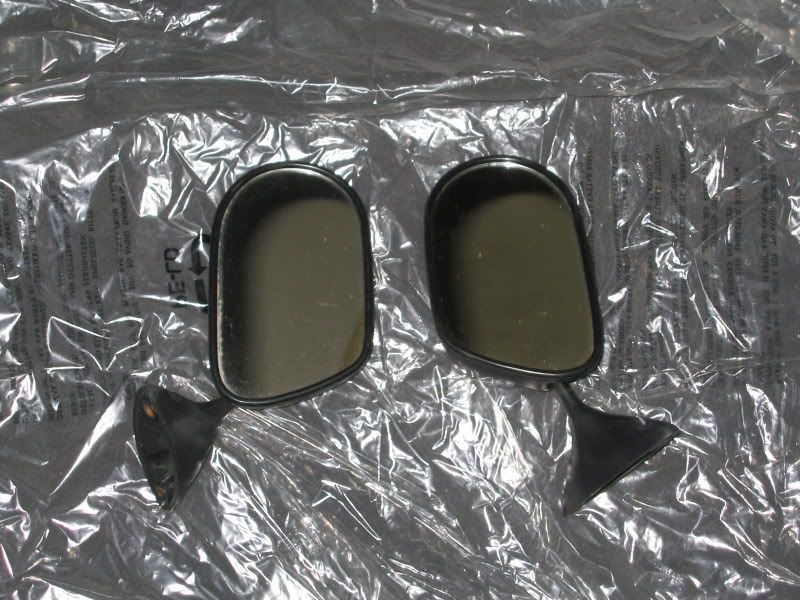

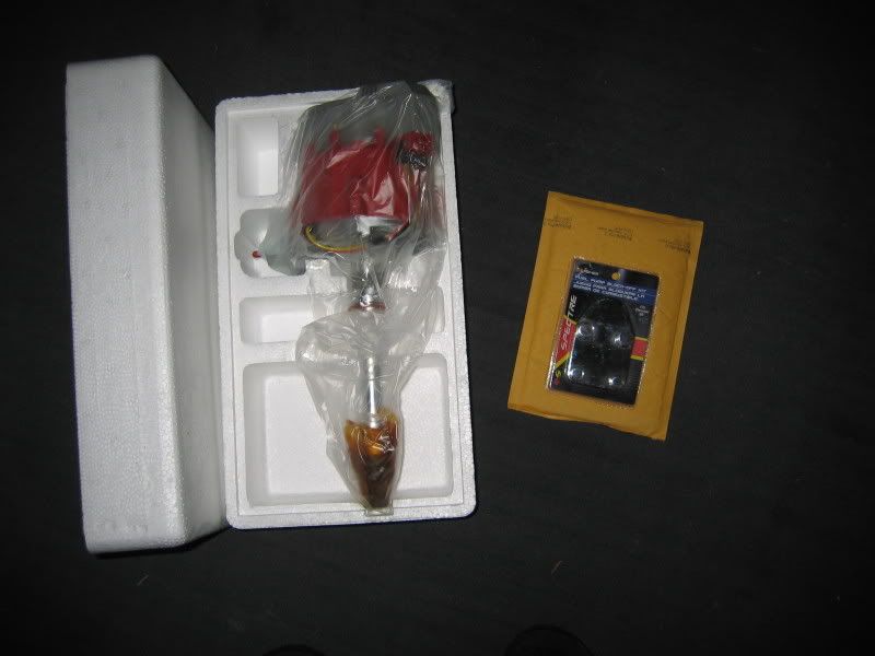

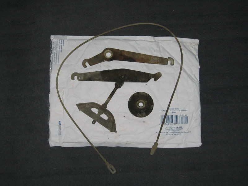

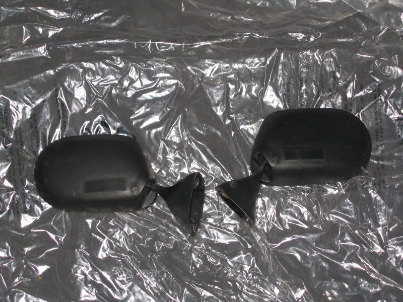

I haven't posted photos in a bit, so here are few more items I've picked up along the way... (Like, when I had a job...ack...)
Thanks goes out to Tazman for the sport mirrors, and CipherX for the E-brake bits. That little plastic wheel is a bugger to find at the yards. The 65K HEI is from Skip White on ebay, and the fuel pump block off was from some random ebay seller...
