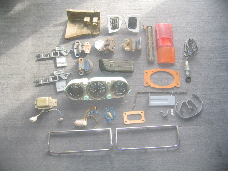

More parts! Courtesy of 'litemup' here on the site. A couple of badly needed items in this box. A full set of door hinges and an ignition switch. Some of the rest will get passed on, so take a look if there is something here you might need. I paid $5 plus $19 shipping, a very generous deal. I'll be happy to pass some of this on at little to no cost...
Thanks litemup :D.
Inventory:
- Pair of taillight surrounds
- Washer/squirter pump
- Factory carb gasket
- Gauge package (cracked cover)
- Voltage Regulator (rectangular plug style)
- Misc brackets
- Factory dash speaker mount
- Light switch mount
- Pair of LUV bowtie fender emblems
- Factory ignition switch
- Tail light lense
- Early (to '76) fuse panel
- Full set upper and lower door hinges, both doors
- Pair Vent bezels
- Relay cover and relays

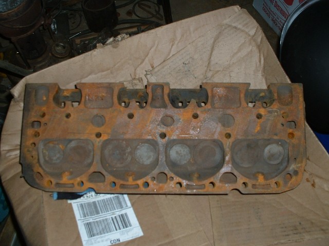

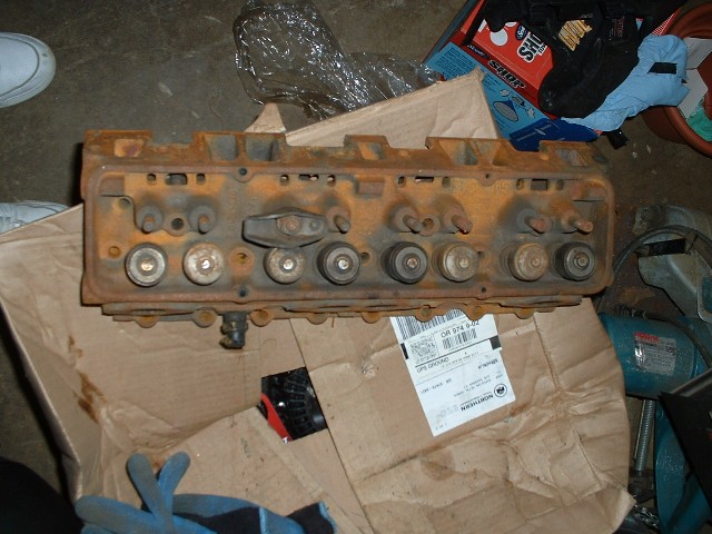

ooh its all nice and clean parts that is a good deal! I ll snap a couple pics of the heads tonight actually here in a minute. how is your block???? did that work soaking it???

okay here is some pics of the heads or actually one of them that I pulled from the shelf they have some surface rust from sitting a little dremel tool could clean them up nice but they are yours for the taking.

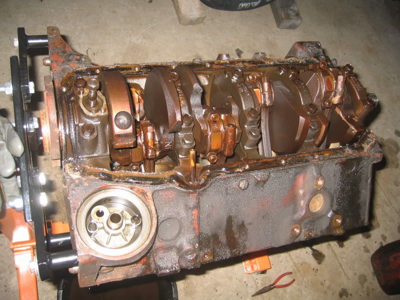

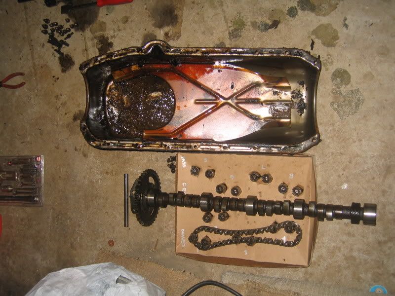

Off last week due to family stuff, but tore into it today and ...
VIOLA! It turned right over!
So, what did I do? I took it apart.
Ran out of time but I got the cam out, and the front 4 pistons out. The mains are in really great shape, the bearings show almost no wear, and once the pistons slid out, the bore's look really good too. The cam looks excellent, all the lifters are smooth and clean, the double roller timing chain is stretched but the wear on the gear teeth looks really even. No stamps or marks inside at all, I think this is the first time this thing's been opened up. Awesome.
I've found a pretty decent machine shop and should have the whole thing over there next month. Just saving for a decent oil pan, rings and head bolts.
The machine shop quoted me $130 to recondition both heads (if it doesn't need valves), $15 to mag the block, $30 hone the cylinders, $14 to blast/clean the block. He gave me some other prices too, but I didn't write them down. Does that sound fair? Seems like decent prices to me...
The wife snapped a shot of me after I got a good look at the crank, and I have to say, I was a grinnin' fool...
More to come :)

sounds pretty good to me! im gettin my bloick done right now and to bore it 30 over what it is now is bout 19 a hole.

I don't have a mic, so I'm going to have the machine shop check the clearances for me. I'm hoping I won't have to overbore it, as I really don't want to spend money on pistons. The skirts on mine look basically unworn, and if they are stock that's a really good sign, right? The rod bearings are thick monsters though, and I don't know if they are supposed to be, maybe it's been gone through before...
I should probably pull all the numbers and check the date code on this thing. Once it's mic'd I'll have a much better idea what I've got. The 4 bolt mains were a pleasant surprise though. :D

Good deal, Nukeday. It possibly could have been into before because that looks like a fairly early block and most of those 4 bolters had a forged crank. That looks to be a cast one.

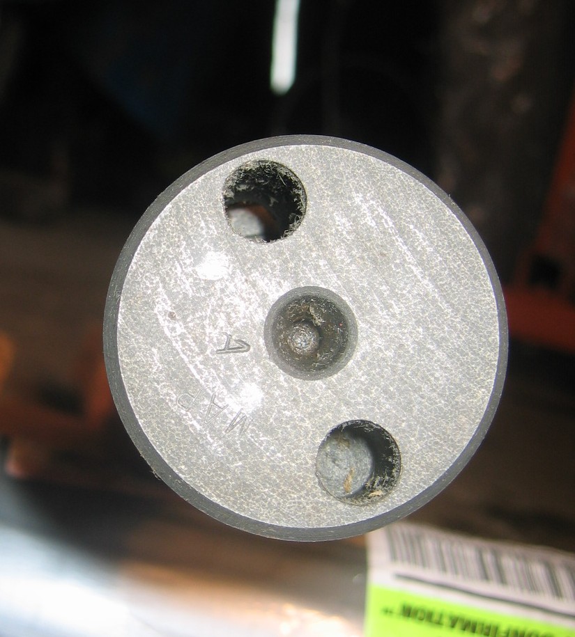

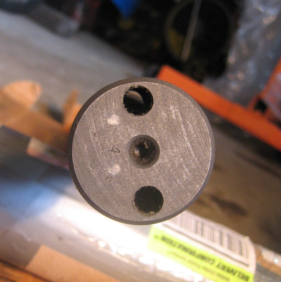

Research today...
I think this is the cam I have...
327/350hp
#229-1713 (Clevite/Mahle PN)
GM# 3863151
222/222 Dur.@.050 - 306/306 ADV. DUR. - LIFT 447/447 - 110/118 LOBE SEP. - PERFORMER - GOOD IDLE
Maybe this one...
Comp Cams #222050A
.390 intake,.410 exhaust lift with 195 degrees intake and 202 degrees exhaust duration.
Or maybe neither...
Anyone have any ideas on this thing?

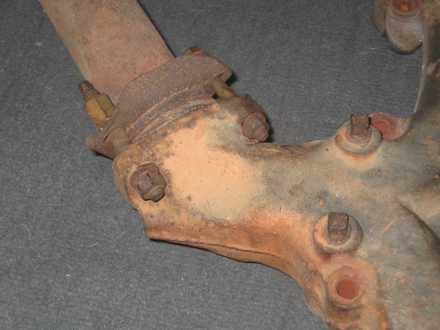

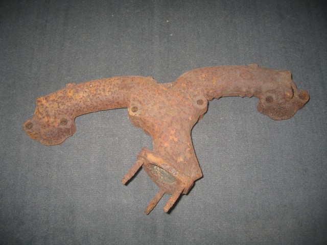

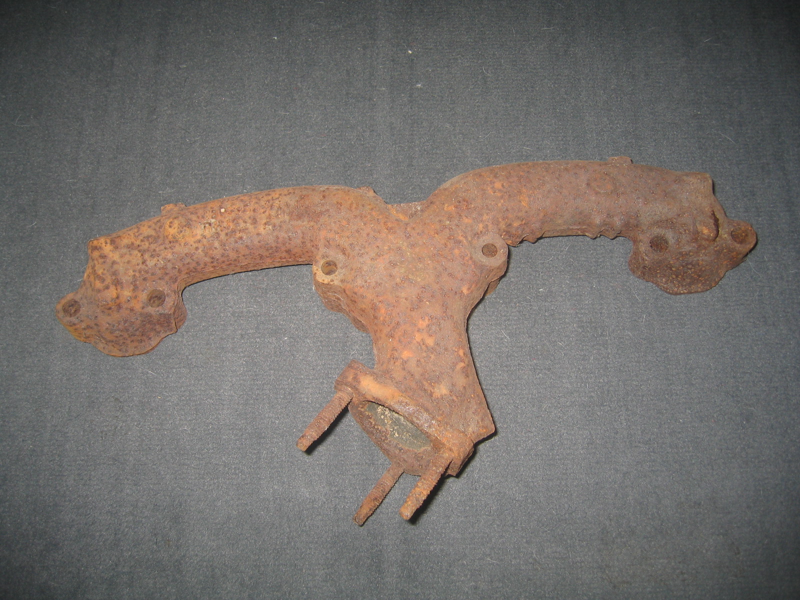

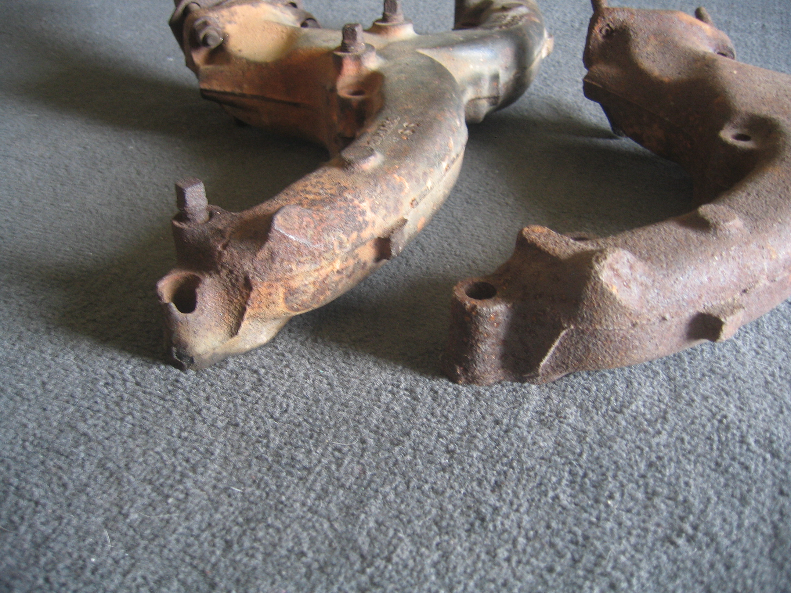

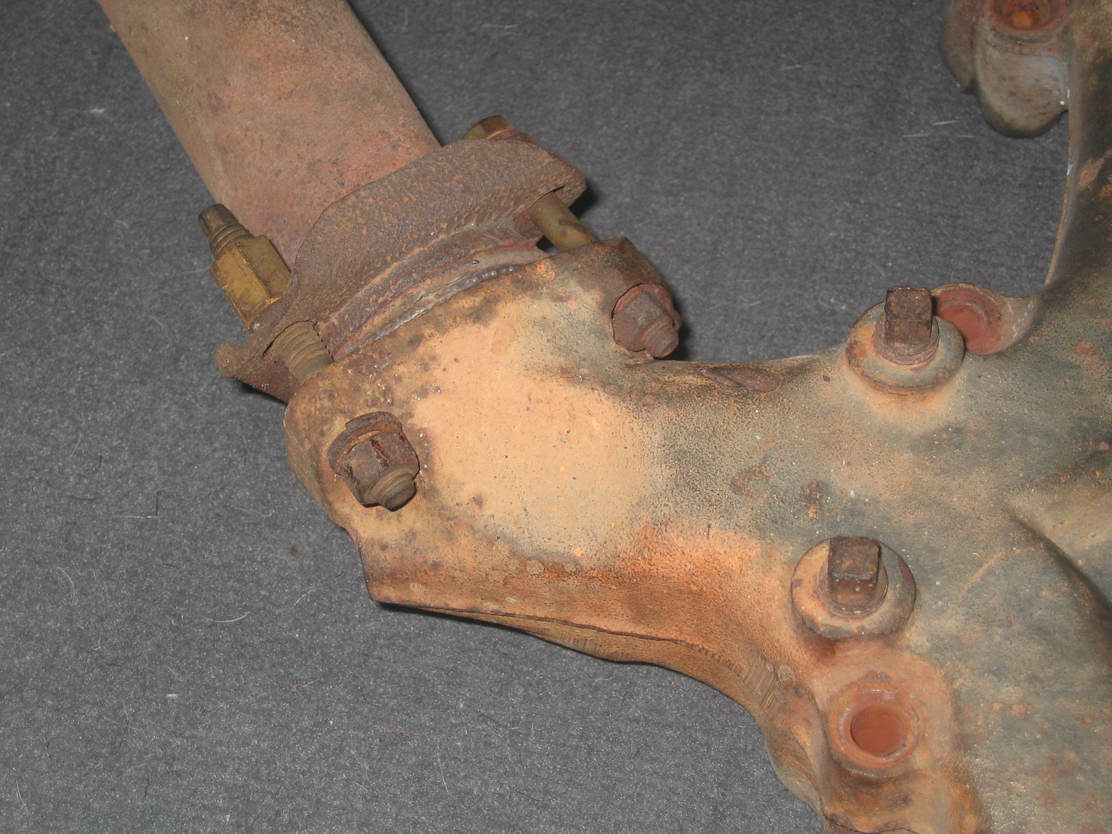

After looking over my ram's horn for the passenger side, I decided to try to find a better one. The unit I have is a smog style, this 'new' one is not. The GM PN is 3896956, RH12.
File comment: 3896956, non-smog ram's horn
The one I have is chipped badly on the front bolt mount, and after talking with the machine shop, it made the most sense to go with a better one.
File comment: Cracked mount bolt, 'new' manifold
Couple of questions:
1. What is the best way to clean & prep these for paint (probably Eastwood manifold coating)? The one I just got is really crusty with surface rust, can I just use a wire wheel on the drill to clean it up?
2. Why are the bolts in the 'original' in upside down? Do they hit the frame, or is this manifold just in rough shape? A quick bit of measuring shows that the total distance from manifold flange to downpipe flange is about the same...
File comment: Modified flange bolts. Just these two, the inside one is a stock stud.
Thanks, I appreciate your comments. This is painfully slow, I know, but I'm getting there. :)

too bad my dad doesn't have the sand blasting cabinet or I could help you out mediablast those and they would be purty! wire wheel should work... however but the grinder version would be better the cone type wheel if you can find one.
In his pic above regarding this crank:
That crankshaft is definately a cast crank, and it is a Nodular Forged version.
I am working on that camshaft for you....
72 L.U.V.

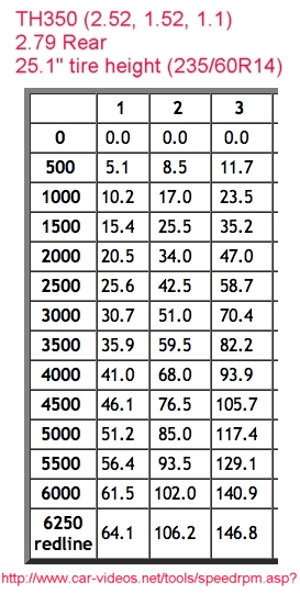

Trying to learn about the rearend in this truck, to get a better idea of where I need the RPM's. I've learned that it's a '77 Ford Mustang II 8". Here's the tag ID:
WDW AA 6AB
2 79 8 53OD
So, I plan to probably keep the tire size where they are but step up to 15" steel wheel w/dog dish caps or baby moons. The truck currently has 235/60R14's on the rear, which is a 25.1" tall tire. A 235/55R15 will put me at 25.2"....
Now knowing that it's got a 2.79 rear, I went here (http://www.car-videos.net/tools/speedrpm.asp?) and plugged in the info for the TH350, the rear gears and tire size. Here's the table I got back...
So, given the moderate accuracy of this, do I need to consider anything other than a stock stall converter for a street driven truck?
Thanks!

That will depend on a few things, such as the camshaft, carb size, head runner size, intake manifold type, etc. With the stock type heads you have, a 600 cfm Holley, if I remember correctly, a dual plane intake the rams horn exhaust, etc. If the cam lift is in the .450 to .460 range a stock convertor should work just fine. A stall convertor works by being inefficient. The more inefficient it is, the more it stalls. The closer everything is to stock, the cheaper it will be on gas (to a point) and the more reliable it will be...
