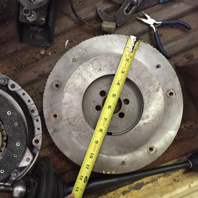

Look closely at the flywheel you got with the tranny, if it has 8 flywheel-to-crankshaft bolts it's not for a 1.8/1.9 engine. A 1.8/1.9 uses 6 bolts. The 1.8/1.9 flywheels are the same diameter the difference is in the bolt pattern that holds the pressure plate to the flywheel, 8.5" clutches have a larger pattern for the larger diameter disc.

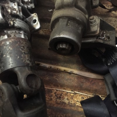

Have you counted the tailshaft splines on your new 5sp? This will indicate whether it's a early or late version, then you'll better know what parts to look for. The late trannies have something like 23 splines, your LUV has about 17, so if you do have a late tranny you'll also need the correct slip yoke to mate to your LUV driveshaft.

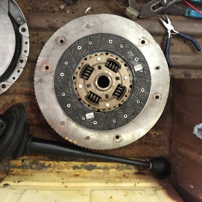

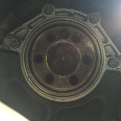

All measurements look the same to me. I believe the 4 spd spline count was 10 and the 5 speed was 18.

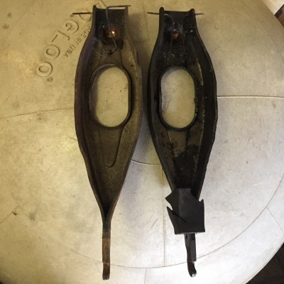

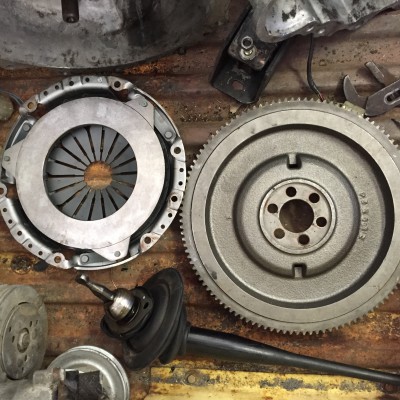

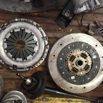

I broke a couple of pressure plate bolts on the flywheel, fixed one. When I took out the clutch/flywheel, the pilot bearing fell out.

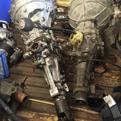

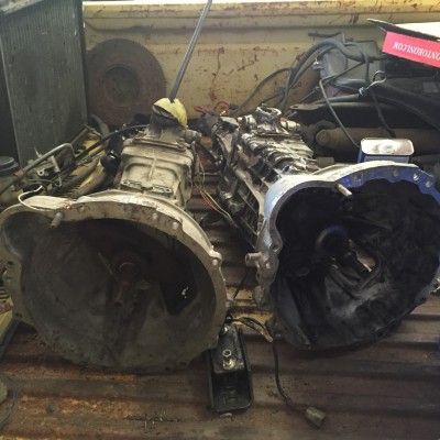

Trans

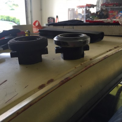

Trans

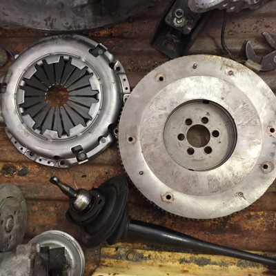

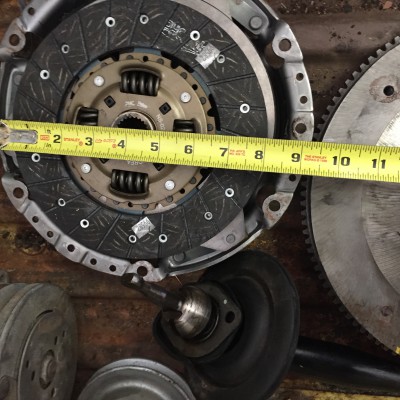

Trans

When you say it was "at the end of it's travel" was the clutch arm actually hard against the opening in the tranny? Are the two clutch arms identical, they look to be in the pictures? Will the 4sp clutch arm swap to the 5sp or is the pivot ball in the wrong place? If the travel measurements are the same and the 4sp worked I'm not seeing where the 5sp won't also.
One thing to try, put the 4sp back in, move the clutch arm in the same manner & see if it also looks like it's not engaging. If not report back on how it's different.
BTW anyone know what his tranny might have come from? It's not a '86-on from the spline count but the starter is on the correct side & is cable clutch. I thought the Impulse trannies were all hydraulic. Will the I-Mark 1.8 diesel trannies also fit a gas engine?

Yes, the fork hits the opening of the transmission. The clutch arms do swap between the 4spd and 5 spd, they are the same.

I'd like to take a look at different pressure plates, impulse, pup, and Luv. The pressure plate I have measures about an inch and a half from bottom to top. I don't know what the others measure.
A seller on eBay has a pressure plate for a chevy Luv 1976 - 1981 for sale. I asked for the height size and he replied, 1 11/16.
