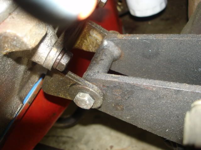

PostPosted: Tue Feb 17, 2009 8:19 pm
Joined: Tue Feb 17, 2009 8:07 pm
Posts: 5
here this is what i did for my 81 v-8 swapImage

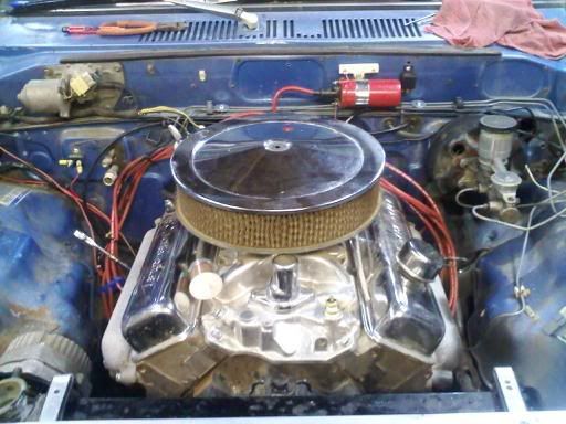

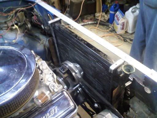

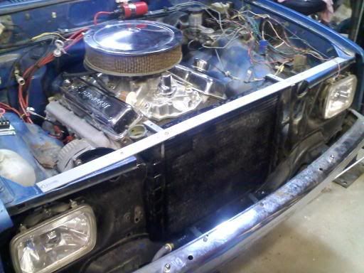

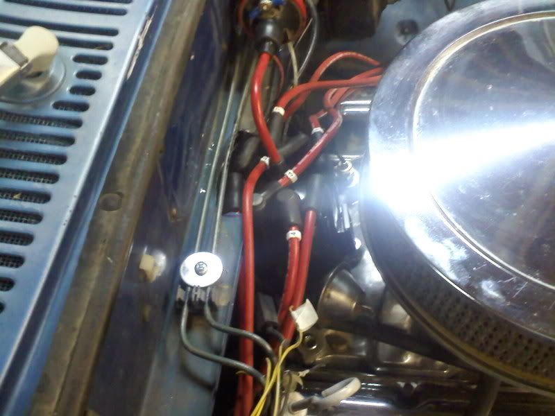

 Post subject: Re: help on a v8 swap
PostPosted: Tue Feb 24, 2009 10:25 pm
Posts: 5
Here's pics of mine.
