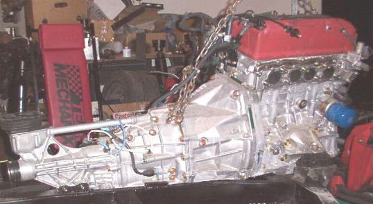

Its a 2004 Honda S2000 engine tranny and rear diff.
Its IRS so thats a plus and the rear frame comes out of the s2k so all I have to do is find one of those at a auction or junk yard and cut and weld lol I know it will be harder but I have alot of people that are going in on this with me.
So far I bought the engine/trans/rear end but I need a wiring harness and ecu and chipped key.
I am considering turboing the engine burt not sure yet I want the motor to run forever like honda's typically do if taken care of.
The s2k engine sits in there about how the stock engine does but I need to make new mounts since the s2k engines mounts in the middle of the engine and the isuzu engine bolts up by the crank pully only about a 4in difference.I will also possibly need to cut a little inside of the truck to get the s2k tranny to clear nice like.see attatched pic
another reason I like the swap I am doing is because the rear diff has a factory lsd which is a big big plus. I will take some pics as soon as I can since my camera is broken lol I broke it while I was out jumping my old 86 fiero lol man I bought that car for $100 fixed a few things took it out to the field and dukes of hazzarded it and killed it all together and some guys bought it for $150 with no windows and not running etc etc lol
