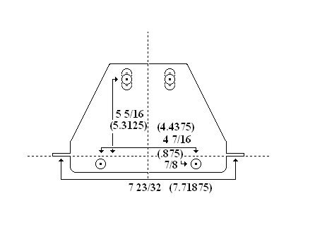

ok here goes my first attempt to post a picture!

sorry, The picture turned out so small. try to save it and print out a copy to read. these are the measurement I came up with today. The mounting bolts are 10mmx 1.5 as far as the elongated hole for the transmission mount I don't know the center to center hole spec yet! I need to but the mount. I measured off a buick single stud mount to get this measurement. I will make a few more notes as far as outside bracket measurement when I get input or I will come up with the specs that will fit on the crossmember. I hoping to get all this info gathered up and send it to a friend who has a flow-jet so and a metal brake so he can produce a few!!-Brian

:idea: well, I double checked all my measurements and this is what I came up with!!. I was thinking it would be easy to make out of a piece of 4x6 rectangle steel, If you cut on the sides and bent them out , it would make the mounting ears and then cuts could be made on the side of the bracket at a angle for the gusset. this would require no welding. please check my measurements off any hooker brackets and I will make any changes. I assume the postion of the transmission mounting hole will change depending on the location of the engine mounts!- Let me know what you think!!

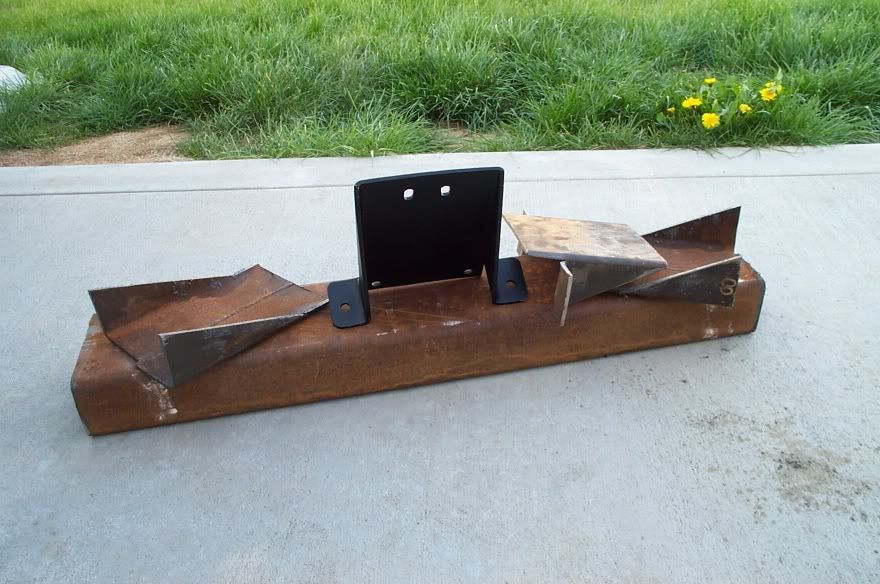

Image 8)
steel scrap $5.00, transmount at napa $5.50, making my own trans bracket priceless$$$$
