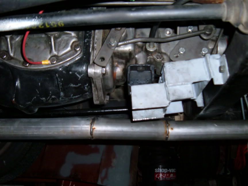

I'm using a super T-10 in mine. I got a hurst indy shifter, and I'm using a hydralic throwout bearing because there isn't very much room for the stock style fork.I had to get a driveshaft made and the shifter is about 6 inches farther back then stock.I'm still using my bench seat but it is pretty close.I can post some pics if you want?

Here's a picture of the trans mount.
ImageI cut the old mount in half and rewelded angle iron in place to so I could drop the mount lower for the T-10.The mount looks like its hanging down, but I got the back of the truck jacked up higher in the rear on jackstands.When its on the ground it sits level to the ground.
